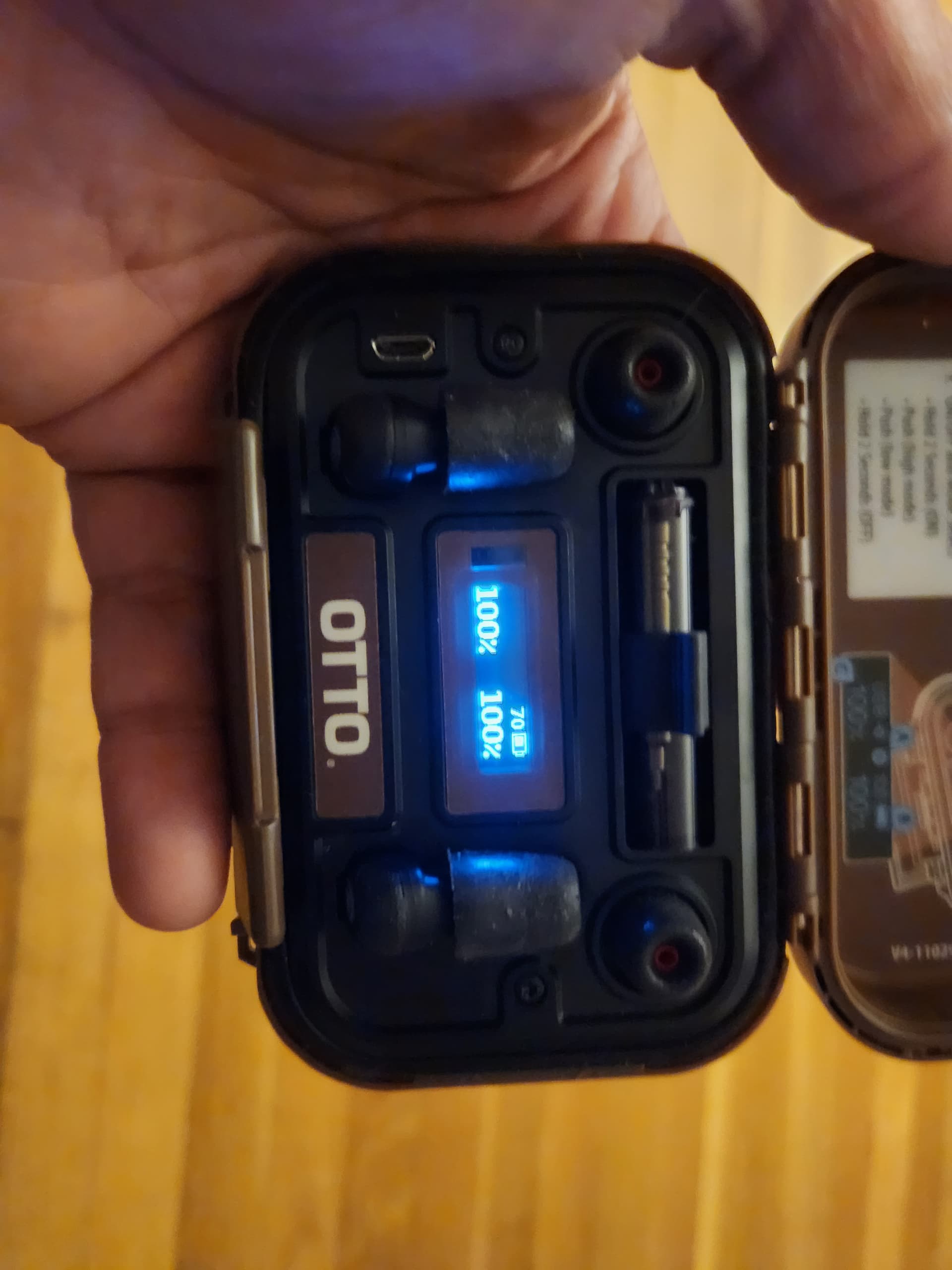

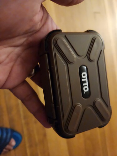

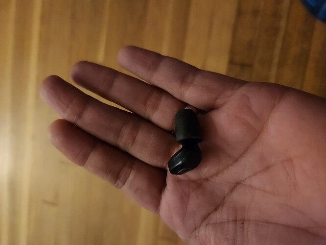

I have used these for a year in all my classes and in-door range, from 9 .45 to 5.56. They worked great! I have tried GS Extreme 2.0. They are ok but cannot compete with Otto for blocking out sound. Nevertheless, these are the best pair of shooting ear protection I have owned.
The good
  • rechargeable case
  • easy to put in your ear
  • Two modes High and low- I never used High. Either outdoors or indoors.
  • Easy turn on
  • Stay in the ears when running
  • Comfortable - 6-hour class. I forgot I had them in
The Bad
  • No Bluetooth- I do not care about that, but some due
  • Tiny and easy to lose
  • To get a proper seal, I needed to buy different ear-tips, “Comply Professional Noise Isolating Earphone Tips.”

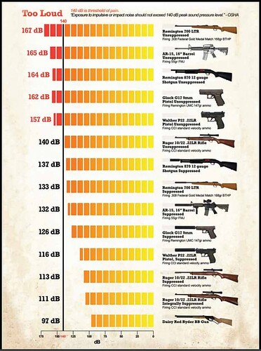

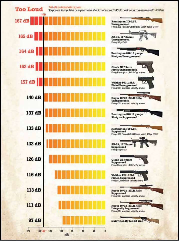

Calculating dB or dBA attenuation is tricky one. It’s not a simple math, like:
150 dB (rifle shot) - 30 NRR = 120 dB… BTW… 120 dB is still too high :face_with_raised_eyebrow:
Sound level (dB) increases on a logarithmic scale, meaning:
if 0 dB represents silence, then
10dB sound is 10 times more powerful than silence
20dB sound is 100 times more powerful than silence
30 dB sound is 1000 times more powerful than silence
When we speak, it’s about 60 dB, plate takeoff sounds at 150 dB, same as rifle shot.
Regular foam plugs are OK… if we don’t need to talk nor listen on the range. These usually cut the high sound levels great, but also lower the level of the voices.
Electronic buds / muffs make all easier for us. These cut (compress) any sound higher than 82 - 85 dB and amplify softer sounds. That’s why using them we can easily hear commands and protect ears from gunshots.
Without digging deeper, the fast formula for getting NRR you need is to use this math:
PROTECTED_LEVEL = [ SOUND_LEVEL - (NRR -7) ]/2
I’ve been using electronic buds (26NRR) for 7 hrs (continuously) and found them as good as foam plugs (32NRR) or SureFire EP10 (30dB) used previously. To hear Instructor’s commands, I had to take out foams and EP10, which was not needed with electronic buds.
Do the math and choose what works for you.
Below you can find firearms sound level values.
