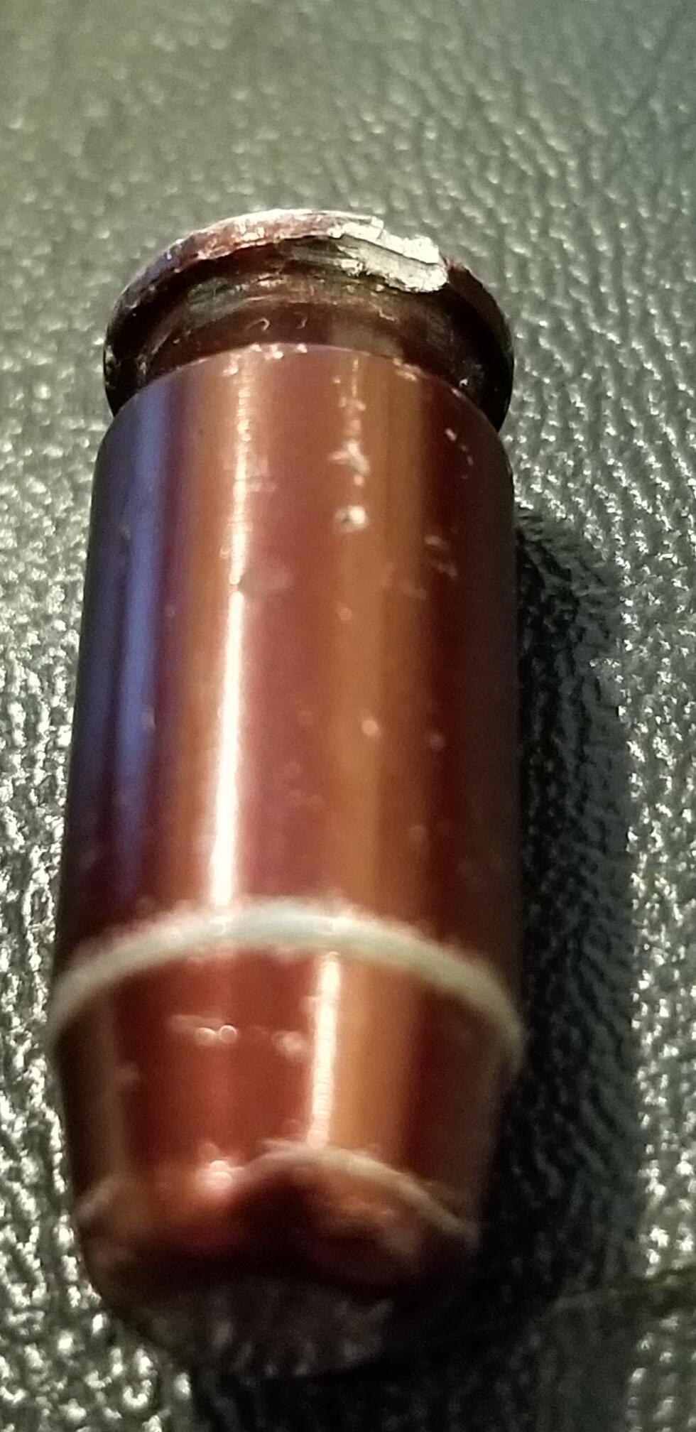

That is disappointing workmanship, but I don’t understand why that prevents removing the roll pin?
Bingo… end of story. You have a mag for a reason…use it
@Harvey
I had the same exact thought you did about the extractor hitting the same spot on the rim. What are the chances of that happening? Things that make you go hum.
@techs
I also hope it wasn’t the milling to the slide that caused it. That maybe a hard fix. Hopefully it is just a piece of metal chip caught under the extractor.
I was going to say to send it back to the manufacturer and see what they can do there’s some type of warranty but it may not cover damage if it was caused by aftermarket work.
Oh man, thats painful. I hope they make it right for you, that seems pretty unexcusable IMO.
Yeah, it’s becoming clear that I will need to change up my normal load procedure. I’ve always done it that way and never had issues in the past, but I now see the reason for loading from the mag and not directly into the chamber! I carry a spare mag anyway, so 1 less round won’t be a big issue for me.
I didn’t want to remove it on my own before talking to the gunsmith about it since some roll pins are different than others. I didn’t want to pull it out and have broken bits all over and not be able to get my extractor back on.
I did get a chance to talk to my gunsmith and he showed me taking it out and all is fine. There was a VERY SMALL bit of metal behind the extractor that may have been causing the issue with flattening the rims.

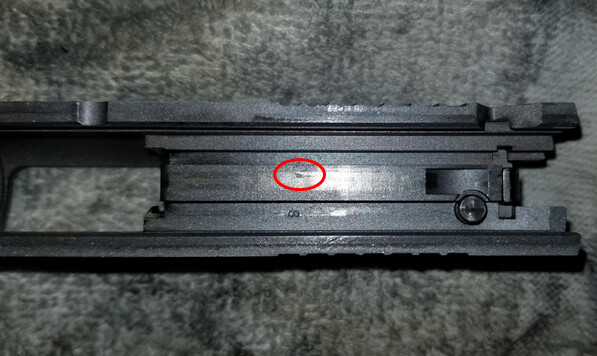

The geometry is so small that it doesn’t take much. This snap cap chip-out brought my pistol to a grinding stop last week:

That doesn’t look good, but you are right, the tolerances are made to fit so perfectly that any small piece of metal getting in the way can cause an issue.
Did that damage your extractor at all?
No damage to the extractor. The slide would only move back a slight amount and jam/lockup in place. Field striping and reassembling “fixed” the problem, but I did not find the snap cap chip out when I field striped it. I believe it fell out thru the magazine well and blended into the carpet :slight_smile:
I have not made it back to the range to test it, but have function checked loading and unloading cartridges, disconnector/trigger reset, thumb and grip safeties, etc. and all seems well. The only scratch indicator I have found is on the section of the slide that operates the disconnector. What appears to be a scratch in the firing pin safety groove (Series 80 1911) is a stamped “S”.
