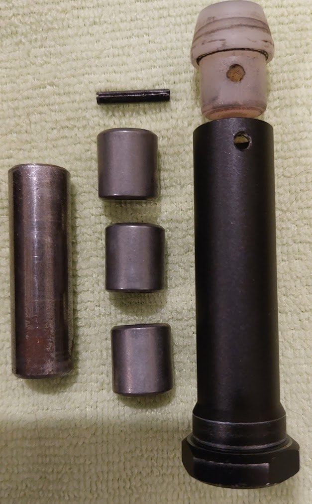

I looked to see what I have for materials.
The buffer with no weights is 1 ounce. I have a 2 ounce weight that fills the buffer, 1+2= 3 ounces (standard weight).
I have 3 weights @ 1.5 ounces each. Stacked together, they are the same height as the 2 ounce weight. (1.5×3)+1= 5.5 ounces (H3)
If I cut the 2 ounce weight into 1/3 and 2/3 sections, then I will have roughly 0.7 ounce and 1.3 ounce weights available.
1.3+1.5+1= 3.8 (H1)
0.7+(1.5×2)+1= 4.7 (H2)
Yeah, I think I can get there from here :+1:
Sounds like that would work! :+1:

Things just got easier, I took apart another 3 ounce buffer and it has 3 equal size weights so I don’t have to cut anything :+1:

Alright, I got out to the range today with an H2 (4.6 oz) buffer, a Std (3 oz) buffer, and materials and tools to put an H1 (3.8 oz) buffer together.
My test protocol was to shoot one subsonic round (200 grain, 1,000 ft/sec) and see if it had enough recoil to lock the bolt back on an empty magazine. Several shots with the H2 buffer yielded no lock-back. I then changed to the Std buffer with identical results.
I then ran similar tests with 150 grain 1,900 ft/sec ammo. It was happy with the Std buffer and the H2 buffer. I think I’m done with subsonic ammo for a while.
