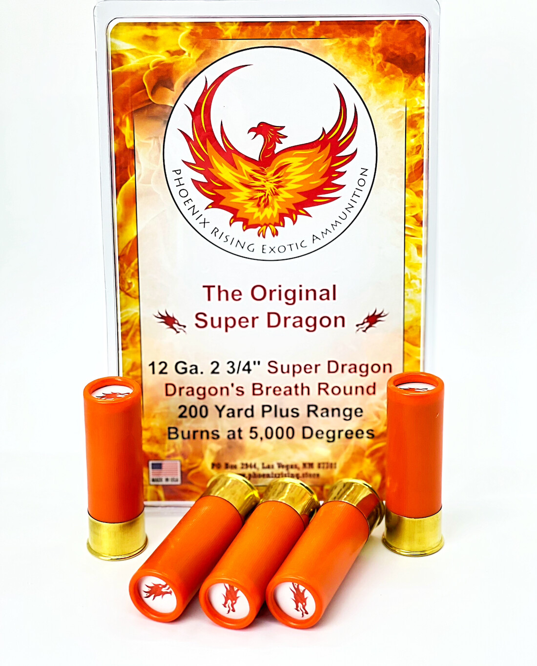

Check this link out.
$80.00
Thanks I’ll check that dragons breath but I saw some of the 8 shot in a Sportsmans guide magazine, I have it in a few diff magazines but didn’t realize it was 8 shot I don’t think . I’m not sure wich one’s better I guess the shot in the 8 ball would be heavier, don’t think I’d want to be hit with any of it. That 27 shot would be interesting to but I’d think it would be a good thing for wolves , coyotes or something like that or just about anything.
