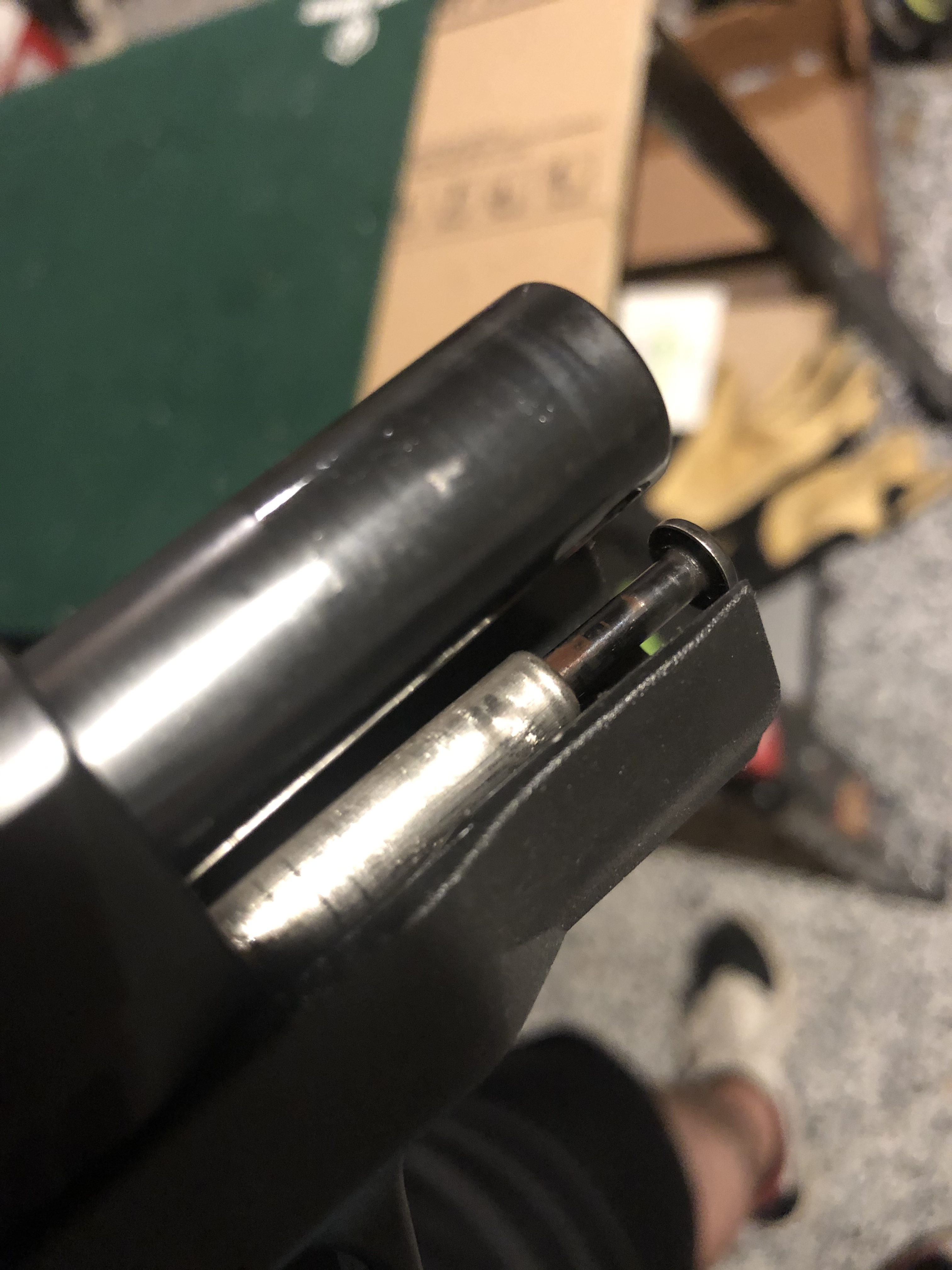

I have found brown gunk in my recoil spring. I was advised by Craig in another post it was probably grease or Lacquer for long term storage. I have read more online and found a few people with the same issue.
S&W actually sent me a new recoil spring, but I would like to quality test it to assure it works before I carry with a new spring Any advice? Not sure if I should just throw in the new spring and be happy, leave it alone till I get to the range (Not sure when that will happen) or try to clean it out more. Here’s the gunk pics.

Use the old one before you get a chance to test a replacement. I know manufacturer says it’s ready to go… but this is matter of life or death, there is no place for trust. Test first, use later.
If you find the replacement working good, no need to keep old one. Perhaps only if you want to play with it, disassemble and clean. But is it worthy?

That’s a well used looking weapon. In the picture it looks like wear and patches of rust to me, but if you say it’s more like varnish, I believe you.
Could it be a heat varnish from lots of rounds in short order cooking whatever solvent or oil was left on the spring?
