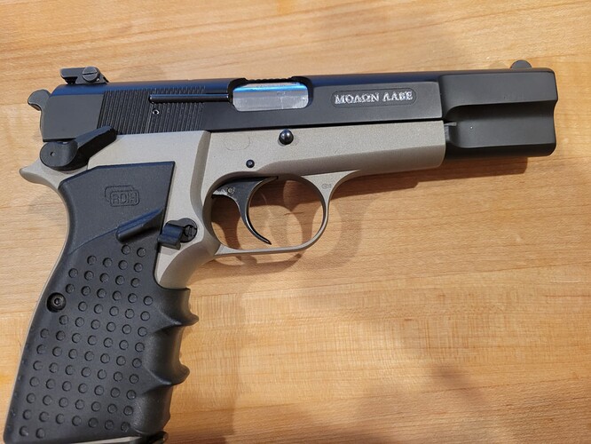

I have a Browning Hi Power that I’ve owned for around 1/2 century. Carried it so much that the original finish had become pretty ragged, so I had it Cerakoted and installed an SFS system from BKSpringsSolutions (in 50 years I had never changed the original springs, so I thought it was time) and added adjustable sights (30 years ago). I really like the new look, but the Cerakote finish made the serial number unreadable, which is a problem for states that require all firearms to have a serial number (e.g., California).
