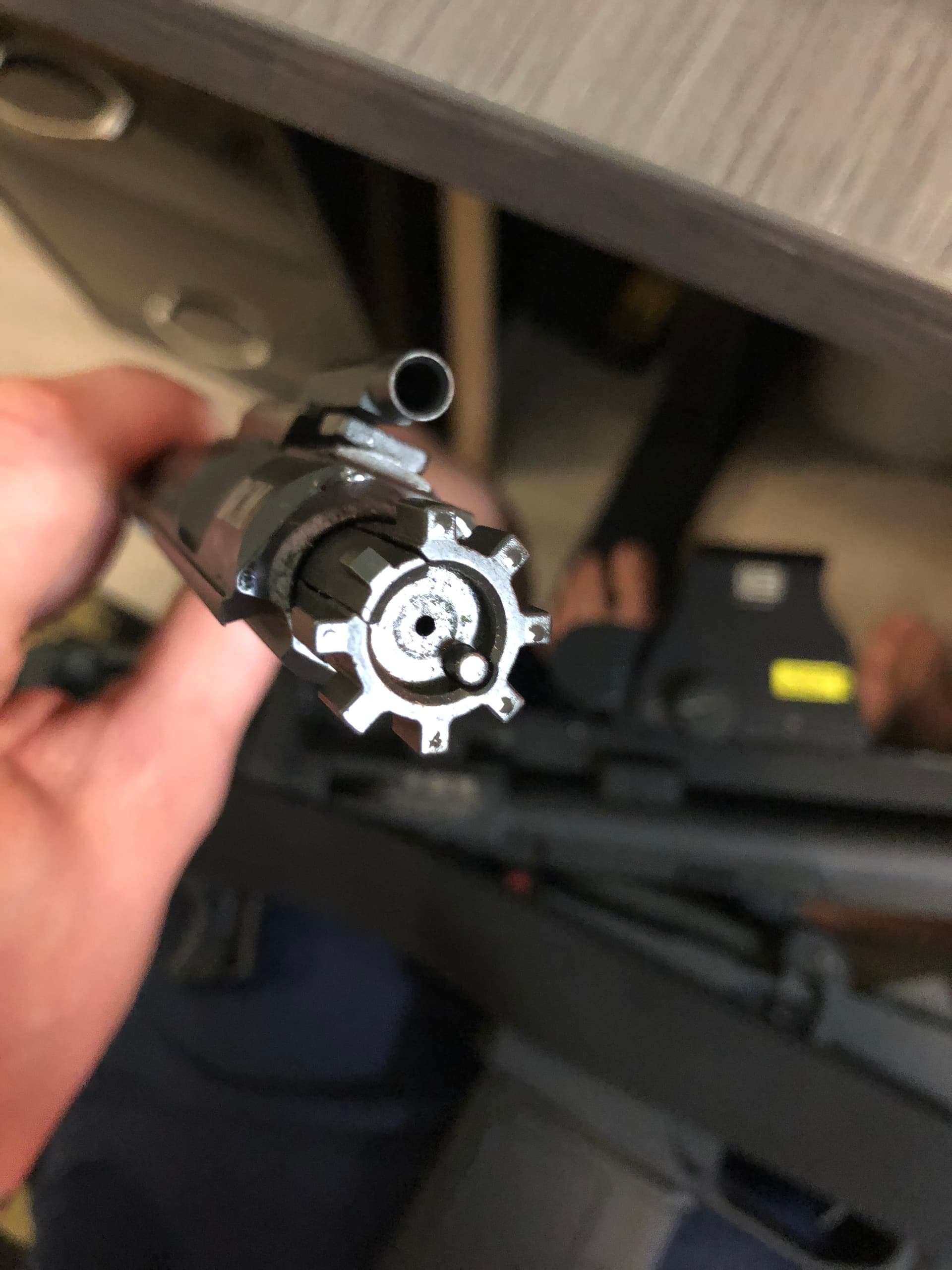

Please take a look at your bolt face. If there is a “ring” the size of a primer etched into your bolt face you are essentially plasma cutting your bolt face through over pressure rounds. You should also look for “swiping” on the base of the casing (it looks like circumferential rings around the base) which indicate that the cartridge is being extracted while under pressure and is being scored by the bolt face.

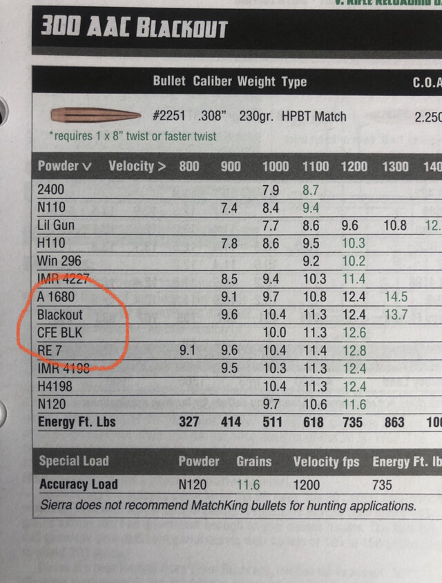

I wasn’t paying close attention when working up loads for 300 blackout a few months back. I was using Hodgdon CFE BLK powder and working up, trying to get a 7.5” pistol to reliably cycle. Sierra put Shooters World Blackout directly above CFE BLK and somewhere along the way while working up, I started setting my increments for the wrong manufacturers powder. I never encounter Shooters World powder and seldom pay attention to their products. Blackout and CFE BLK both make me think Blackout in my thought process, especially with the cartridge being called Blackout as well. I didn’t blow any primers by going over max in this instance. But I was not paying full attention and made a mistake. (I never got reliable cycling.) My point is that it never hurts to double and triple check everything.
I usually grab my Lee manual first and I appreciate the powder manufacturer abbreviation ahead of the powder type. It’s an absolute necessity with the 4895’s since multiple manufacturers use the same number. Could Sierra have added the extra information, sure, but it’s still my mistake at the end of the day. They could have at least not put the two powders with similar names so close together in the listing.

The brass is a huge hodgepodge of random brass. Some 300, some I trim from 223… I’m gonna go to the range and do a test to see which lengths cause the problem since I think the seating depth is the culprit here. I did find a “ring” on the bolt face that I don’t see on my other bolts, so I think that’s the issue. The powder is exactly what it should be according to the bullet manufacturer specs.
This is the point I needed. I think I’ve got short lengths, and too much seating depth. Gonna confirm at the range.
