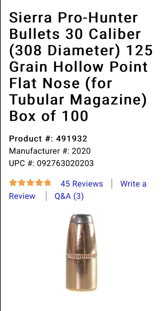

I harvested a wild boar in TX with one of those before aac claimed the cartridge. I haven’t tried them yet feeding from a magazine.
