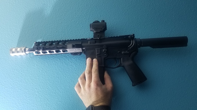

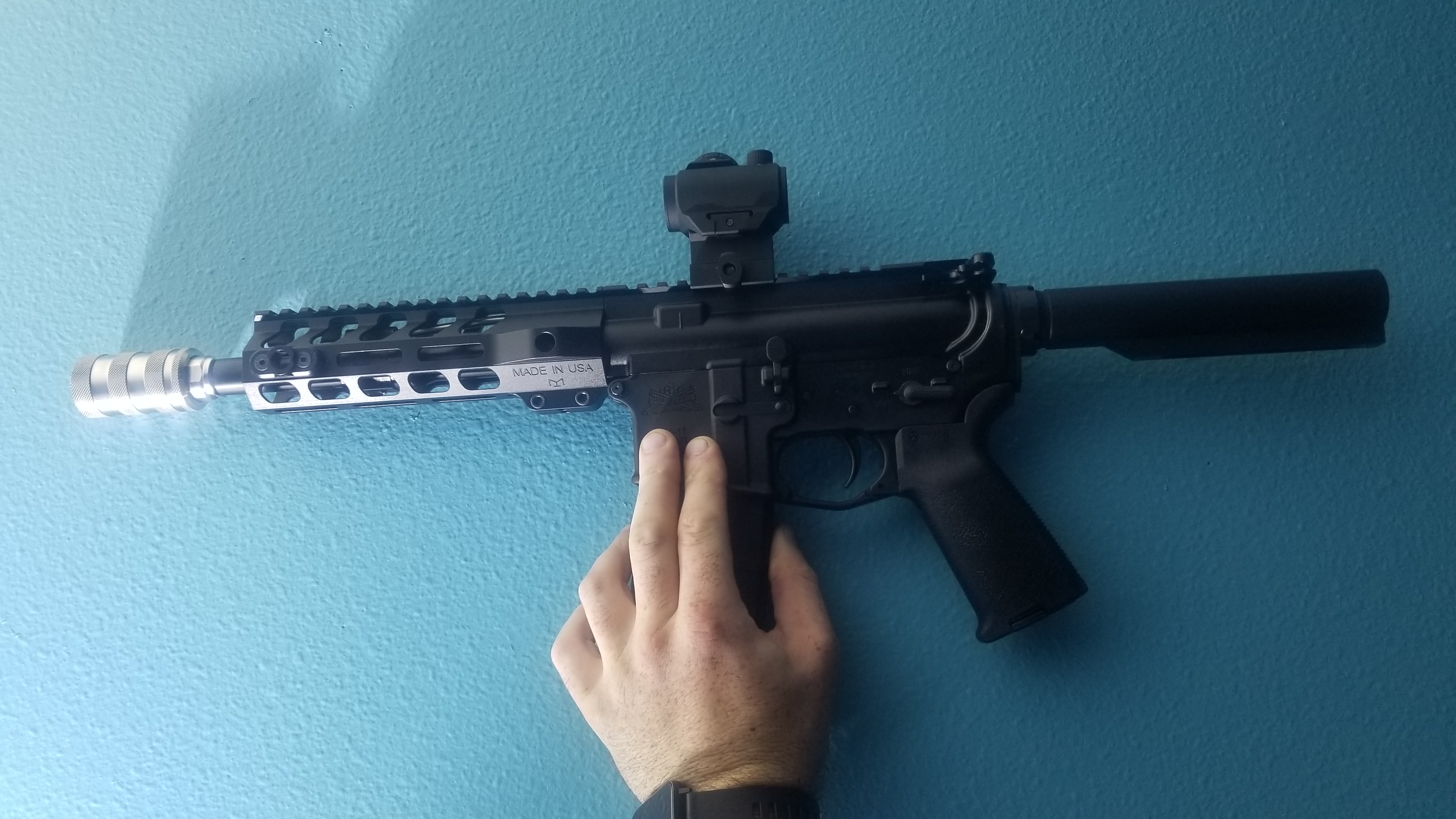

Thanks for all the input. I don’t post pictures of my firearms however it is completed and I’m just waiting to get to the range to zero it in.
Front to back
Standard A2 flashhider on a 1:7 twist 10.5 in barrel chambered in 5.56
Front sight is a standard fixed front sight post
Went with a midwest industries drop in quad rail hand guard. (Possibly going to add a magpul AFG and flashlight)
Optics I’m going to try the Trijicon RMR I had mounted on my ACOG and use it since I don’t like it on the ACOG. I got a co witness mount.
Rear back up sight is a Magpul flip up.
For a brace I went with the SB3, thank you @Craig6. I looked into the SB4 but the 3 fit exactly what I was looking for.

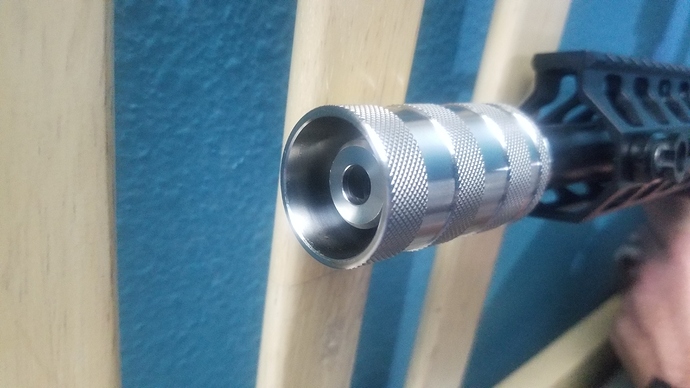

I picked up this stainless steel flash can on Ebay for $26 for my pistol with 8.5" barrel.
It has some weight to it but I like that its 2 pieces. Havent had the ability to test but it looks like it will perform nicely.
