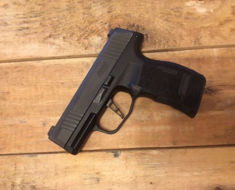

Also bought a flat trigger, sanded the trigger bow and polished the trigger track. Flat trigger works well for me, trigger finger placement is not as critical, and trigger pulls seems much better, making me shoot a bit better. Considering getting a disconnecter cut on the slide someday.
My Sig P365 is stock, looking for a flat trigger for it as well. Liking the new flat trigger on the Sig. Too bad I got it after a range weekend…
