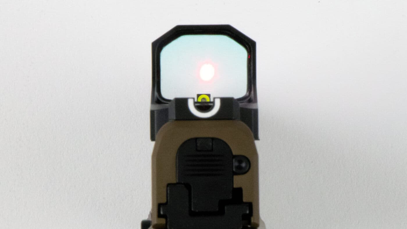

I recently tried to pair the Swampfox Sentinel to my Hellcat OSP.
Swampfox called them a match. I’m afraid I did not read the fine print where Swampfox recommended their suppressor height rear sight be included in the mix. I like the Hellcat rear sight so I’m in a pickle.
All I can see of the front sight is the very tiptop through the optic.
I tried for one picture example here
It’s rather difficult, especially holding the pistol in one hand, to get a camera in place to properly focus while also trying for even semi close alignment
