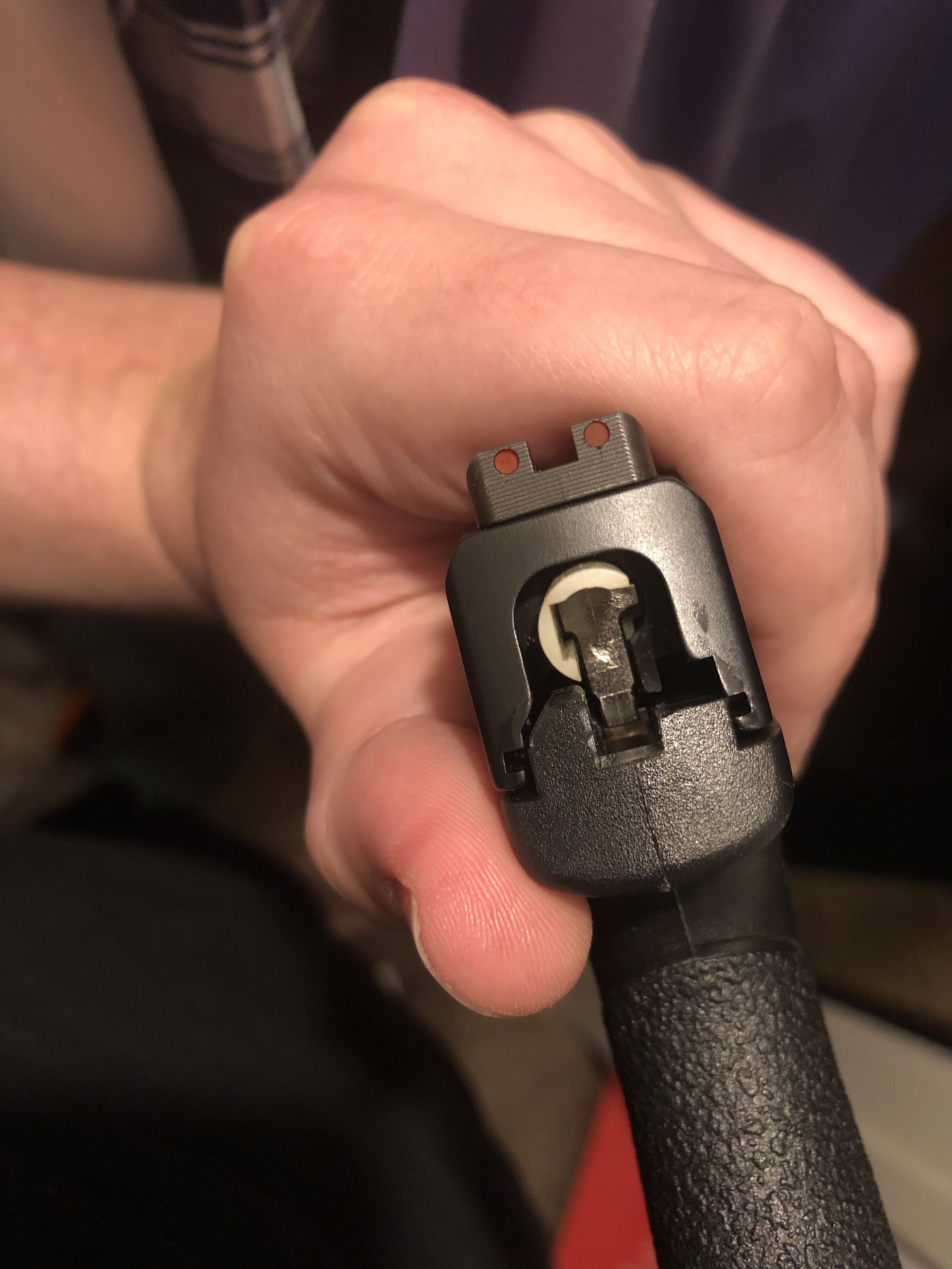

So I did more research lately on my M&Ps and discovered that the striker in an M&P is close to 98% pulled. When the trigger is pulled the seat travels down and the gun fires.
A Glock is pulled at %60-70 and the pulling of the trigger pulls the striker back to %100.
I have been moving to AIWB, and I have the absurd fear of my M&P slipping from the firing pin and then passing the firing pin block…
Any thoughts?

I really like my M&Ps, I just have a level of uncertainty with a striker being cocked at %100 all of the time (I’m pretty sure Hks, XDs, Walthers all do this. It’s part of the reason they have good triggers).Guess that’s typical for a 1911 though.
I did look into research on CZ-P07s and Glocks, but I would rather not retire my M&Ps.
These pieces would have to slip, which I assume might be impossible, but yet I still have my conserns.
Edit: I reevaluated this on another M&P and I’m really not worried anymore. It just requires thorough investigation before holstering a firearm that could potentially point to my junk.
There’s not enough room in the striker channel for the striker to move without the seat moving, and the seat is under a fair enough amount of spring tention. That is very unlikely to fail, but even if it did, the firing pin block would stop it.
The gun is not going off unless the trigger is pulled.
That’s why these handguns use striker block. Do not overthink this, you are safe with M&P with AIWB as long as you don’t press the trigger… or your garment doesn’t pull it… :wink:

Now that we have that out of the way let’s talk about guns. I really like the photos you provided along with the explanation. I need to go through that again. It does make me feel safer knowing that bit of info.

What I don’t understand is how the striker block is the 3rd safety in an M&P I understand the sear is spring loaded upward, the striker tension pulls it in, and the shape of the sear is angled outward for safe surface tension (though many people modify this part), but I’m not sure if that really counts as a “3rd safety feature” since the striker is under almost 100% tension.
Though I’d also argue it’s probably just as safe.
Edit, I answered my own question. This all results in a safe firing pin block that is extremely unlikely to be effected by a drop or heavy force, and if that were to occur, the firing pin safety and trigger safety both fill the gap.
