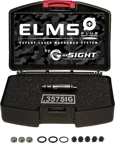

I have not used the Stikeman system. The one I have used for the past few years is the G-Sight system by ELMS. I can put the cartridge into my regular carry gun to train. This allows me to be able to train with the gun I would potentially fight with.
Do you have to rack the slide after every trigger pull with that system?
I have to rack the slide after each trigger pull with my Glock, but not with my Taurus. I usually use it with the timer training option, within the accompanying G-Sight app, to get my draw-to-first-shot practice done.
It can get annoying to have to rack the slide each time, but I take that as an opportunity to practice as if I am clearing a malfunction between shots, using the Tap, Rack, and Roll method, and getting two shots on target.
If you don’t have DA (double action) handgun, SIRT is your option to train without racking the slide each shot.
When I’m dry firing my EDC with laser I’m simulating malfunction after each shot. Tap-rack-reengage. Exactly as @Calvin_USCCA posted.
