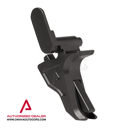

I know it’s a little late for this thread but Agency Arms came out with an aftermarket trigger that DOES have a safety tab.

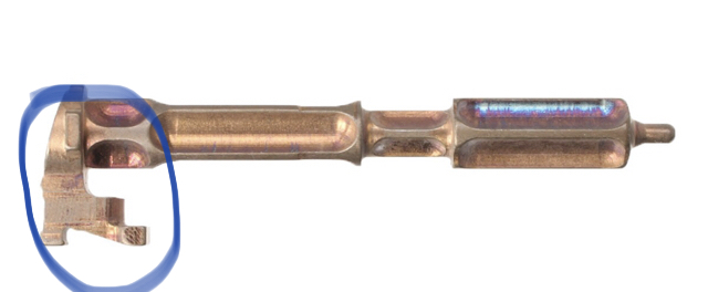

  1. I don’t like the firing pin design. The part of the firing pin that makes contact with the sear, and the part of the firing pin that makes contact with the striker block are the same piece. (Glocks and M&Ps have contact point for the striker block in different locations on the firing pin). It seams like a decision made to slim the gun down, but I don’t like it.
Edit:
P365
Glock
M&P
The common argument against this is there’s tons of 365s and no ones having problems. But that’s not the same thing as saying the design is designed with optimal safety in mind.

Both of your concerns were purposeful engineering design choices by Sig. There is more than one way to get from here to there and every design choice has pros/cons.
As many P365s as are out there now, some of them with really high round counts, they both seem to be unfounded concerns about safety or reliability.
