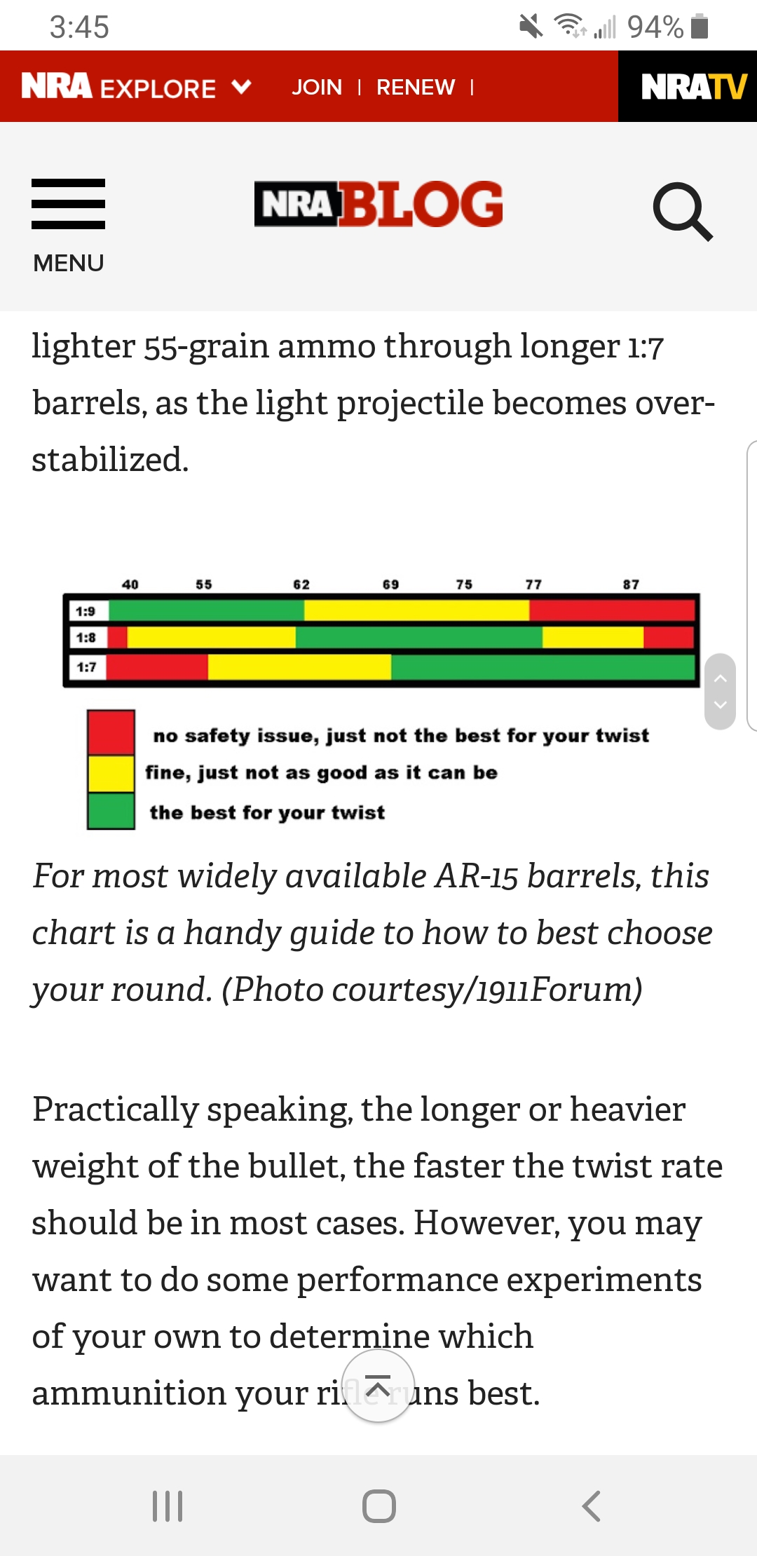

The rifling is what affects bullet accuracy from what I’ve learned. Here’s a screenshot of a chart about bullet grain and twist from the NRA in a very simple to understand format.
Screenshot_20190310-154535_Samsung%20Internet
Just as a side note as well, I’m not saying you don’t know this, but just for everyone, bullet grain is not the amount of gunpowder behind the bullet, it is the weight of the bullet. I’ve heard a lot of people say otherwise.
