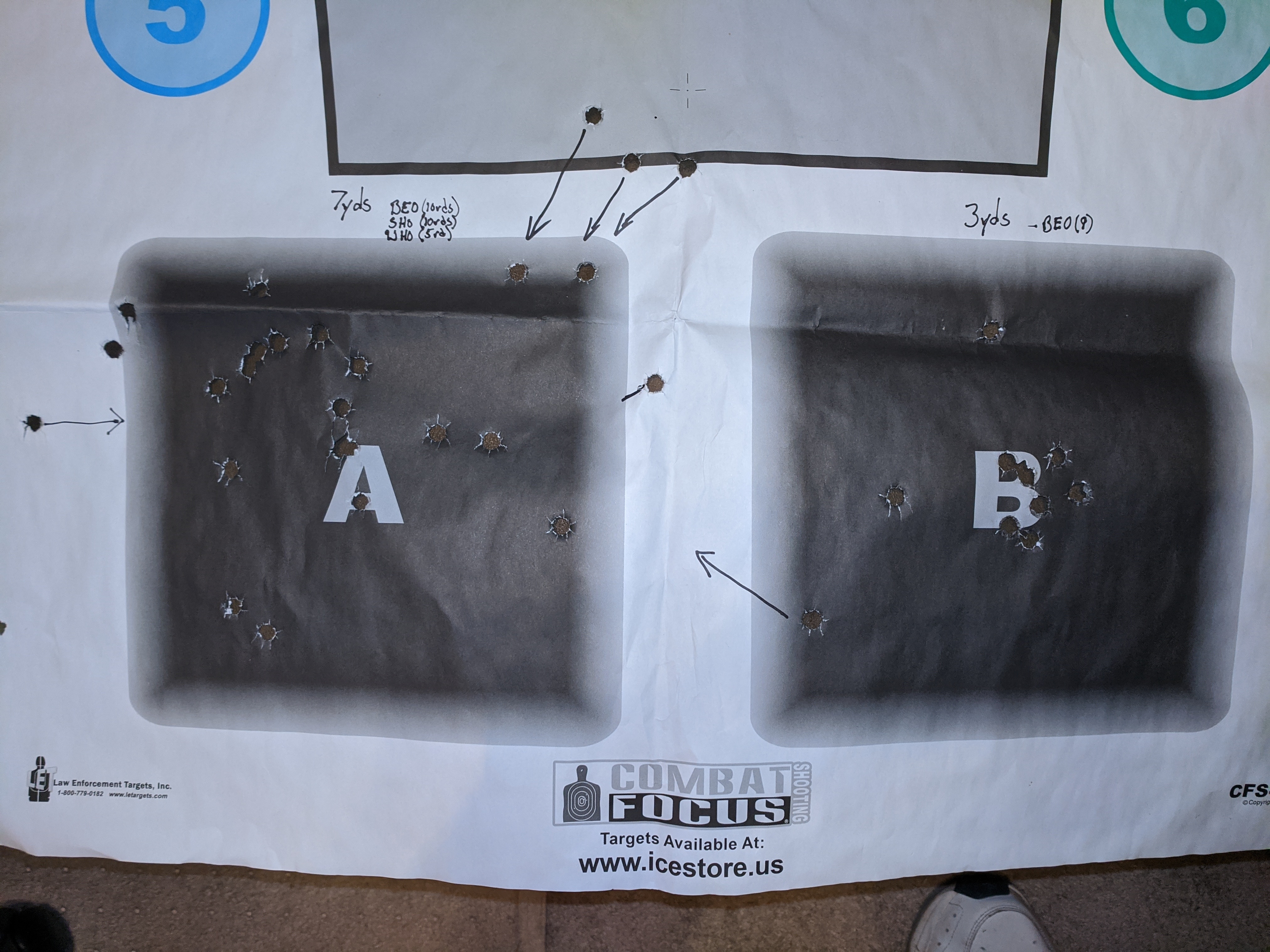

Below are the targets I was shooting at yesterday…target “B”, 3yds BEO 9rds (from the draw rapid fire, one flyer high)…target “A” 7yds BEO 10rds slow from low ready, 10rds, strong hand only aimed, 5 rds week hand only aimed. Three misses along the tope were from weak hand firing…Stray round in the B target was from BEO, the other three outside the box were either from BEO or strong hand only.
At 7yds I have to aim (put the front site on with BEO) towards the bottom left (midway between the A and the bottom left corner and more left than low) of the target box (8"x8") to get centered. I think it’s just the way my eyes start lining stuff up once I get to a certain distance (any thoughts/recommendations welcome)
Kind of hard to tell without seeing what you are doing while doing what you are doing :face_with_monocle::crazy_face:
Since it appears you get to the range fairly often I’d like to see two different “clean targets” with the same POA, same stance, same grip, etc for accuracy. Use say a 2" dot as the target (aim small -miss small) Just let me know if you use lolly-pop or center hold. If you really want to test yourself shoot a blank target at 3 yards and then at 7 yards WITH YOUR EYES CLOSED. Say five rounds each, hold the gun out there and squeeze off 5 at each range, no peaking between shots :blush: I have been able to learn and teach much using that drill.

The simple answer… max distance is the distance at which you, personally, are defensively accurate. If you are good at 15 ft… then the answer is 15 ft.
If you aren’t accurate at a distance with both eyes, that’s the time to close one. Of course you can extend your range with practice, but today, you are where you are.
The tradeoff is losing that additional information on what’s happening around you. But if you’re missing the primary threat because you had both eyes open, that may not be working in your favor. Stop the threat with the accuracy you need, assess with both eyes immediately after.

This tells me you’re having trouble with your sight alignment when you’re two eyes open.
That’s the way it should work… controlling the front sight results unless error at the muzzle which translates to much less error at the target.
