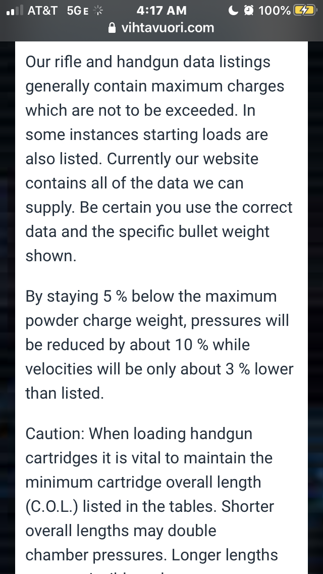

It took me a minute to find this again but I like the middle paragraph. Richard Lee says something similar, but I found this first. My interpretation is I can save 5% on powder and gain 10% less pressure in stress and longevity for my firearms and only give up 3% velocity. Then I thought it might work the other direction and started looking at the powder requirements for magnums and ultra magnums for honesty not that much of a benefit over 30-06 and now appreciate the old workhorse even more.
