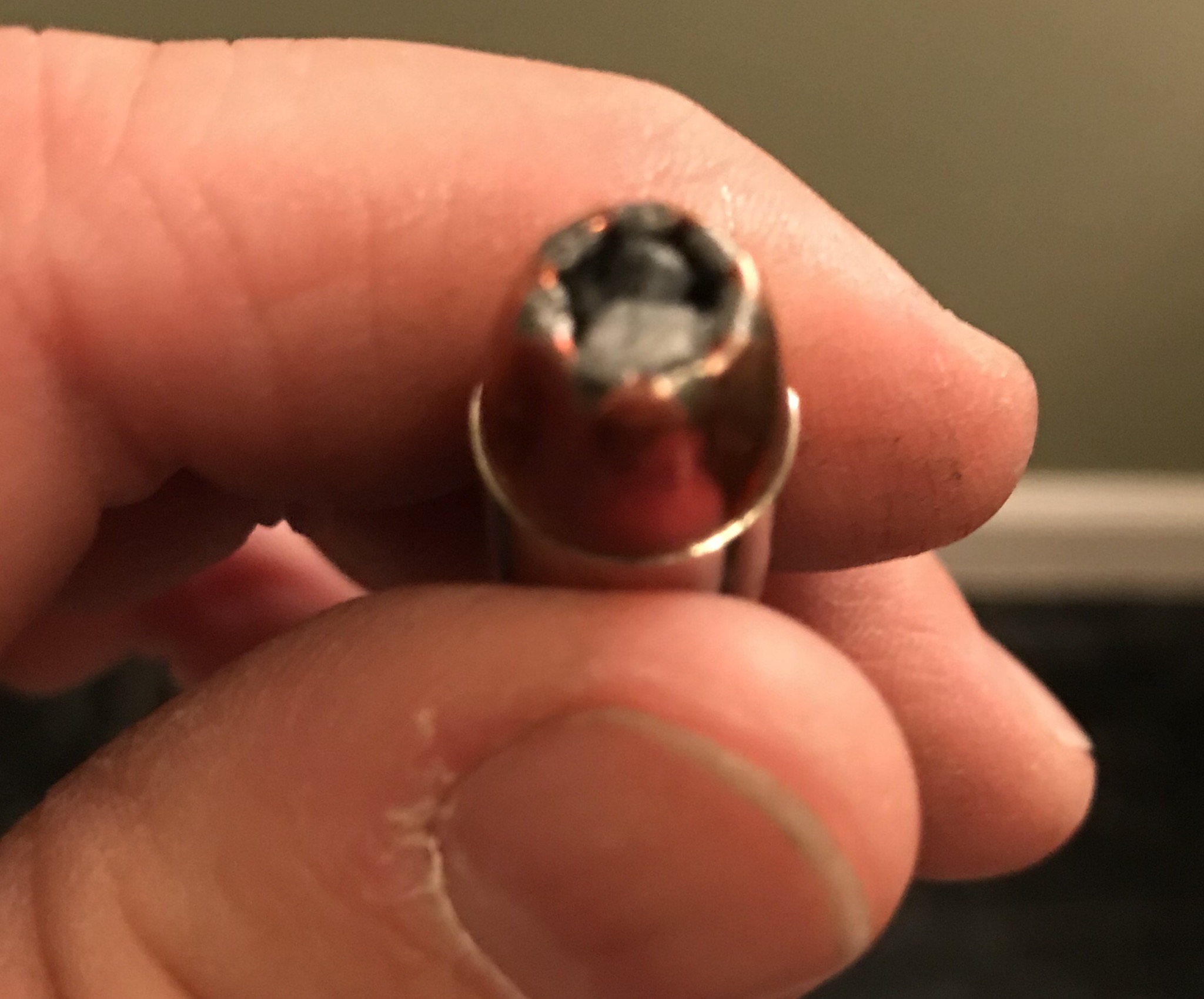

Here’s why you should check you mags as well.
That hollow point was full of lint. Probably wouldn’t have opened. This was the second round in the magazine. The first was fine.
@45IPAC Thanks for the pic and the demonstration of the necessity to clean the mags, too. I think I learned something valuable from you just now.
Not only clean the magazines. You also should check your carry ammo from time to time.
