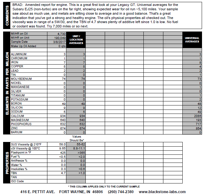

brad what did you find with your oil testing??? My auto dealer keeps sending emails telling me I am past due for oil changes, etc. I only put 4000 miles on in per year.
I’ll post the results. Everyone changes their oil way too soon!

190k miles, much of it towing with the little 4cyl.
That one above was gets 5k intervals because I’m in love with it. This second car has the same engine (but with much lower miles), after 7.5k intervals and nearly 100% towing time. Note that the leftmost column of data is this interval and that the prior oil change (third column from left) is at 5k interval, for comparison. Enjoy!
