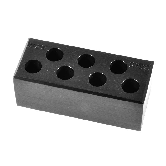

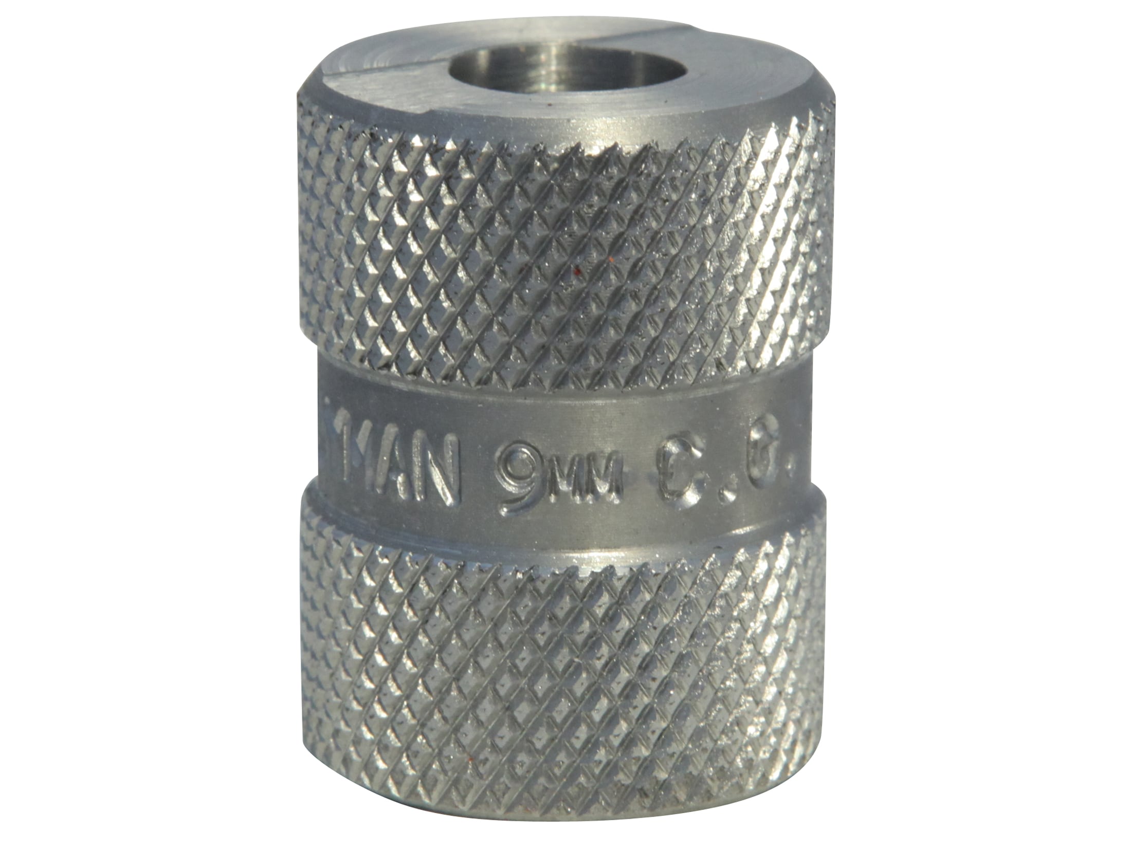

You could always buy a cartridge gauge and drop rounds into it for a better-than-eyeball check before loading them into the mag

If you want to use something besides the barrel/chamber from your pistol, I prefer the EGW tool. However, the kerplunk test is a sure thing.
