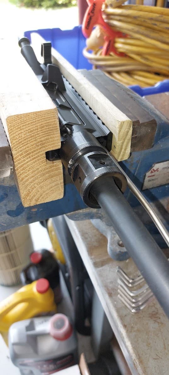

So, to complete this thread, the routered 2 x 4 holding fixture worked out! It would have been nice to have a third hand holding both boards and the upper in place while snugging up the vise, but I persevered:
Please forgive my messy garage!
The new 14" handguard installed with the old 10" for comparison. Part of the gas block sat outside the 10" handguard.
