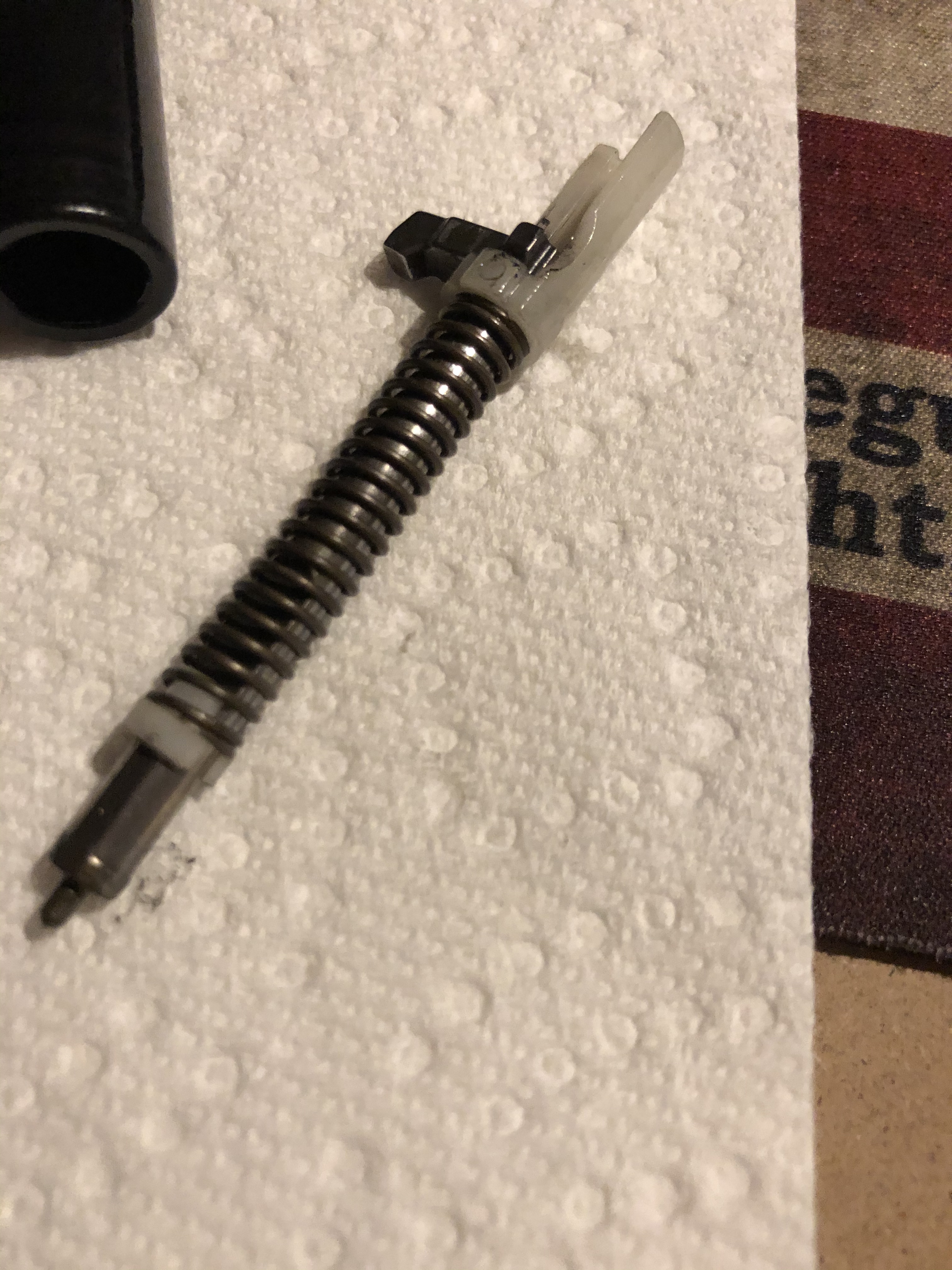

I cleaned the Striker/ firing pin channel on my M&P 2.0 today. I found the same thing. It was relatively clean, and didn’t really need it, but some day down the road it would. My goal will be to do this every 1,000-2,000 rounds. (Which For me is 1-2 times a year or when I feel like it).
Here are some pics
Cleaning firing channel and striker every 2,000 rounds will be more for pleasure than necessity
Do not forget to take the striker apart for cleaning.
