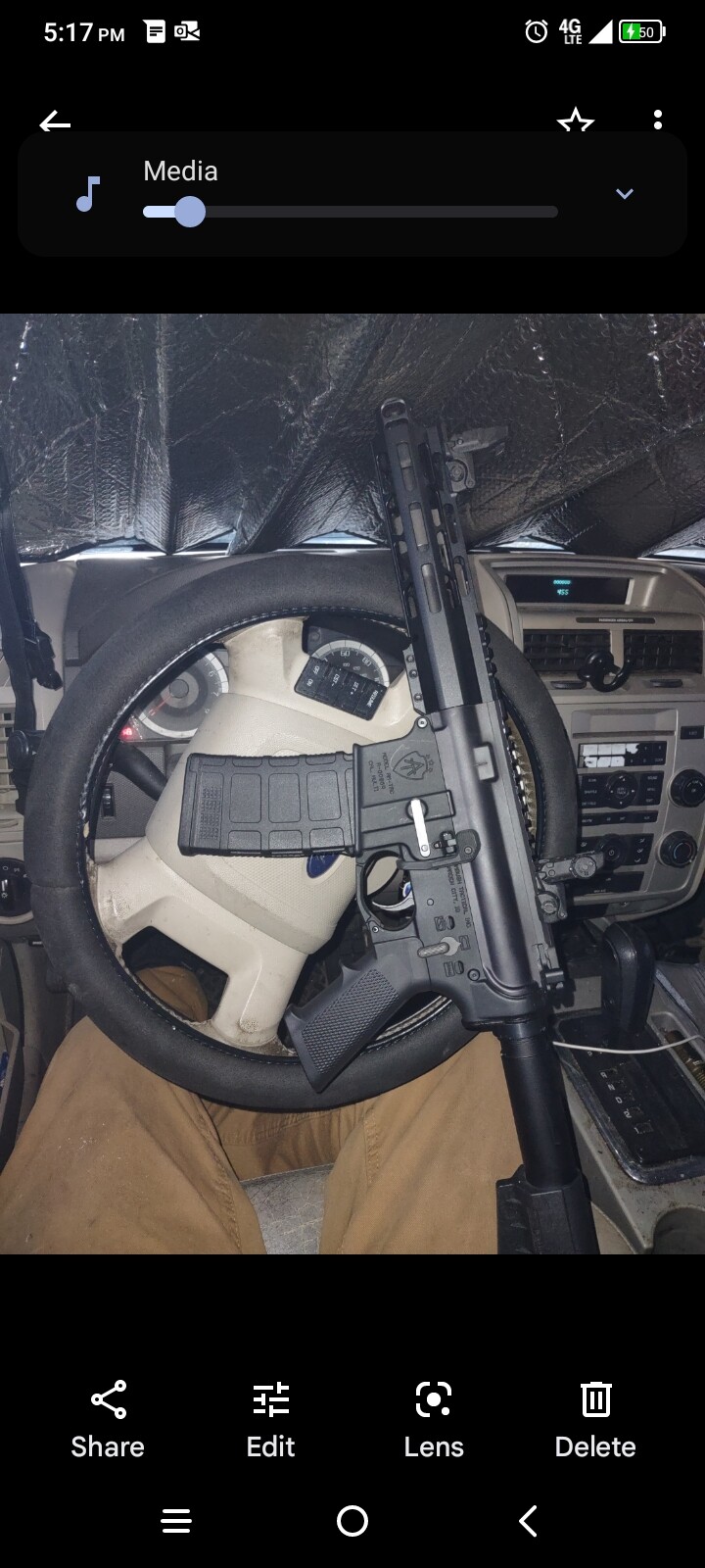

I have a AR pistol 7.5 I forget it’s not in front of me but it’s like a something tactical my name umm
but I guess you want to go too if I can use the same bolt carrier and charge handle for this new barrel? I think it’s all just generic firearm it only cost like 600 bucks

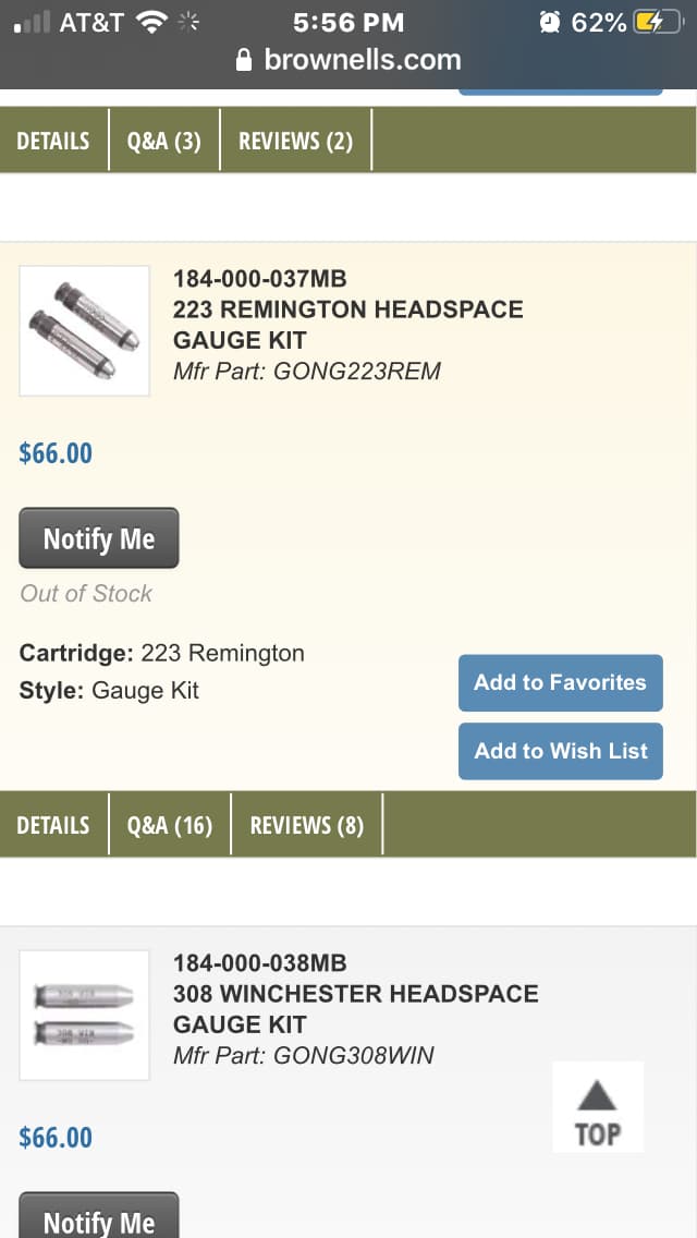

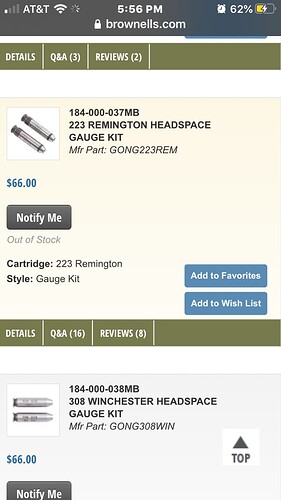

The cost of those headspace gauges are close to the cost of a bolt carrier group.

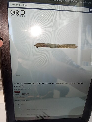

This is a complete upper with a bolt carrier group with correct headspace ready to go.

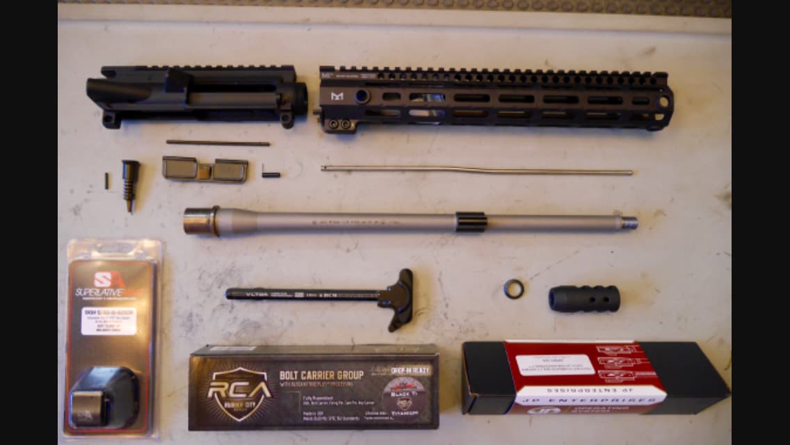

I think what you are calling a new barrel is a complete assembled upper without the charging handle and bolt carrier group.
You can just change the barrel in the upper assembly you have now, but most likely you will need a longer gas tube and a roll pin as well.
I am so confused lol here’s some pictures for contacts but I just don’t plan on getting the upper with the bolt carrier and the charging handle I want to know if I can swap out the one in the AR pistol. It’s 556 NATO… Ect
