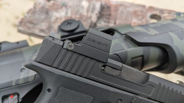

Taped Up Mozambique
Another big issue shooters have with red dots is forgetting that it’s a target-focused shooting method. A lot of shooters have had ‘front sight focus’ drilled into their heads for decades. That’s a hard habit to break. This red dot drill helps you transition to a target-focused shooting method.
A little tape goes a long way
Tape some blue painter’s tape and cover the front lens with it. You shouldn’t be able to see through the optic. The tape forces you to focus on the target. If you focus on the dot, all you’ll see is the blue tape.
Set up a man-sized target; a silhouette of any kind works. I’m partial to the FBI Q target. Take a position seven to ten yards from the target and start holstered or in a low ready position. We can sneak some presentation practice into this simple target-focus red dot drill.
This focuses you to focus on the target and not the dot
At the signal, present your gun and fire two rounds to the chest quickly and efficiently, then transition to the headshot. Make sure you keep a target focus. If the target looks blurry, you are doing it wrong. With a target focus, the tape is a non-issue. The dot will bounce all over your target and be superimposed over your vision.
This solves one of the biggest red dot problems
The Mozambique drill allows you to shoot quickly and with precision in one drill. It will show you the accuracy and speed capabilities of a dot when you focus on the target.
