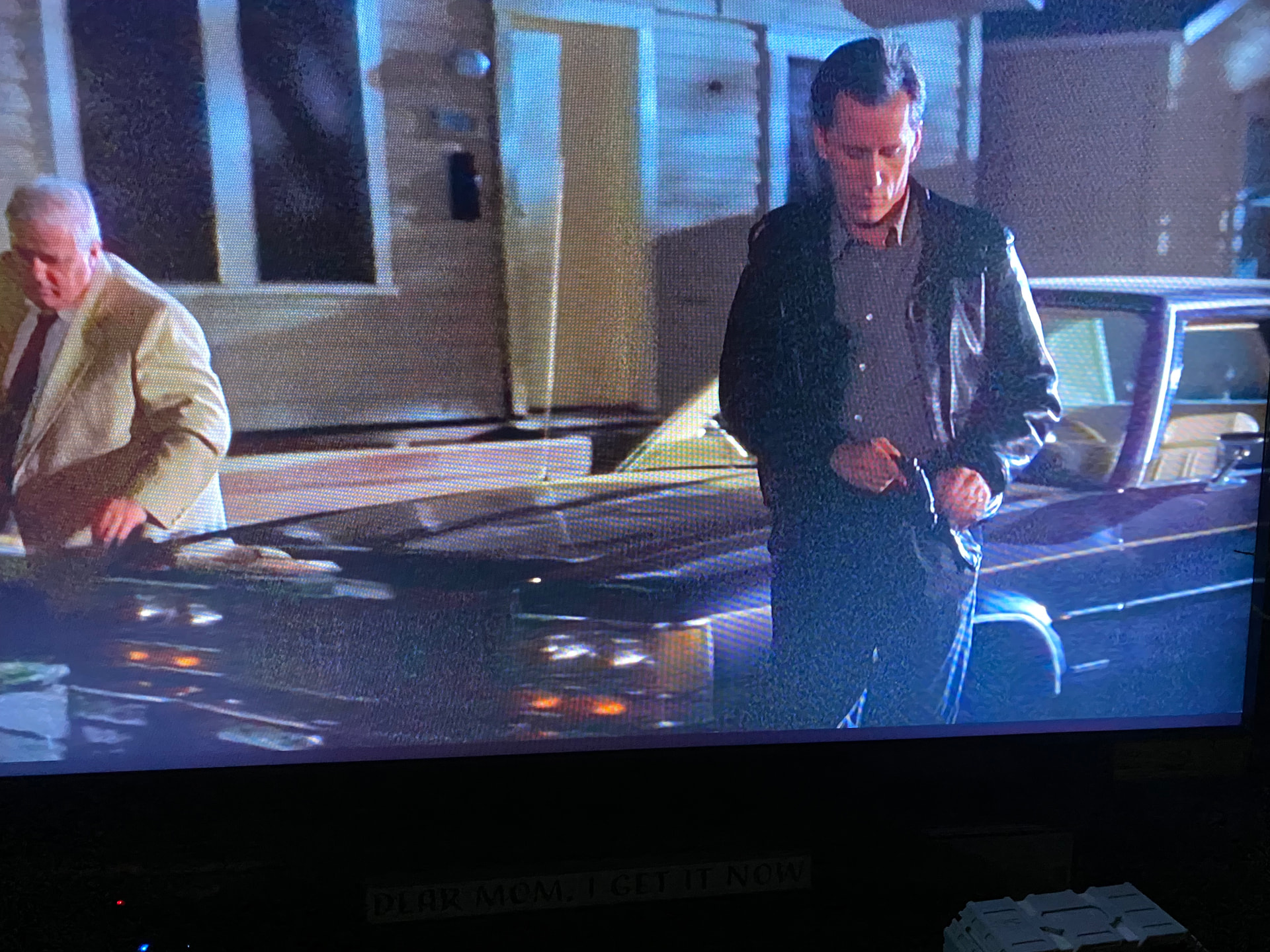

Now, you made me look. In the “drunk” scene, James Woods made sure his EDC, in his right hand, is good to go by opening the cylinder and spinning it with his left hand—counter-clockwise. Not that it matters if you could spin it clockwise and not do any damage to the gun.
In another scene, he loaded dummy rounds and did the same thing. Then, he played Russian roulette with a dummy, gun in his left hand. When he cocked the hammer, it went in clockwise :worried:direction.

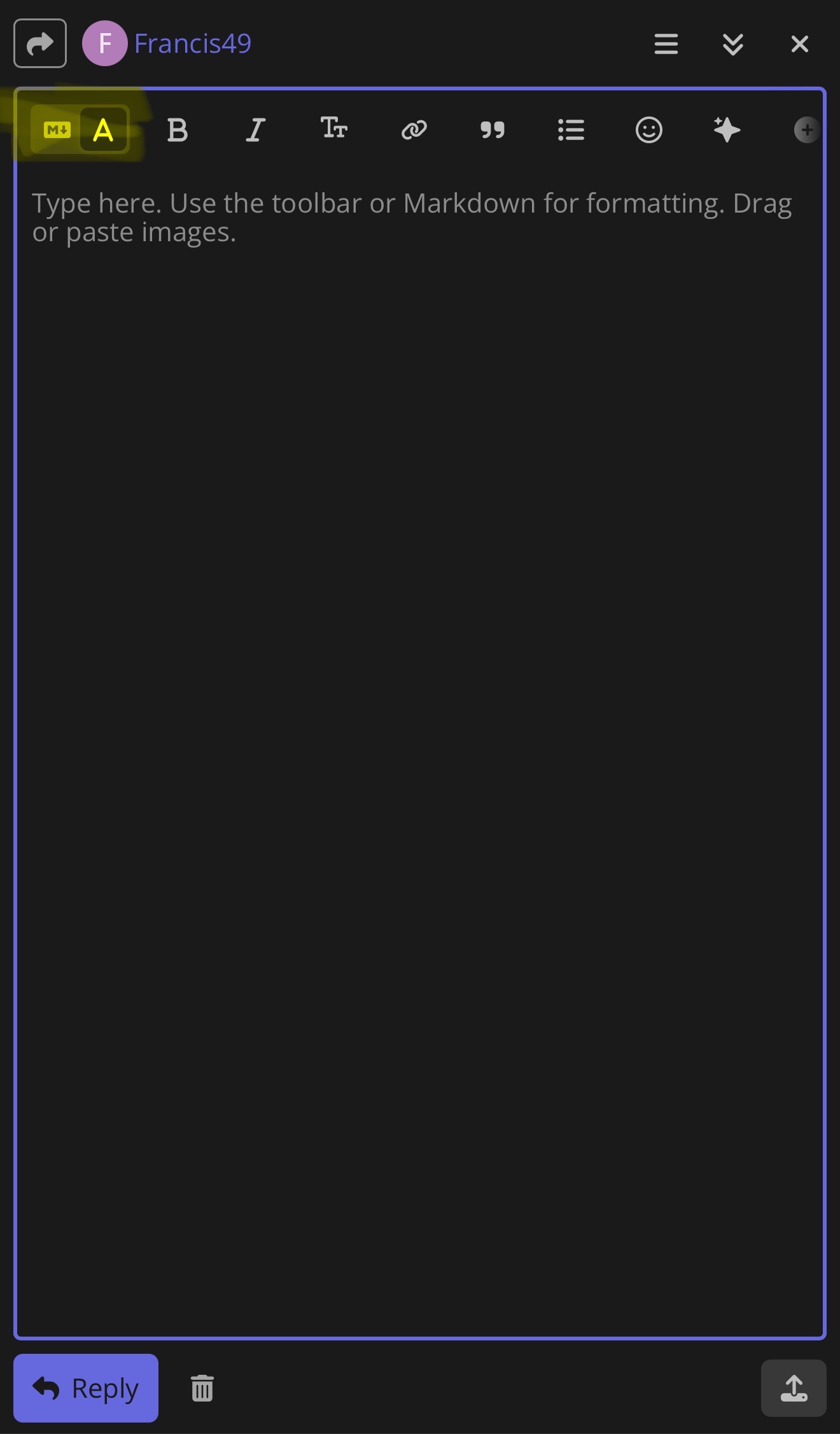

Sorry everybody! I’ve tried about ten times, and every time I try to copy the link and paste it here, it switches from the actual link address to the “cylinder rotation” link, which is a general link to The High Road and not the link from 08/20/14 titled “cylinder rotation”. I even tried to type in the address manually and it switches to the hyper link “cylinder rotation.” Maybe you can find it, because I’m done with these computer mysteries.
Try switching this toggle in the left hand corner first
