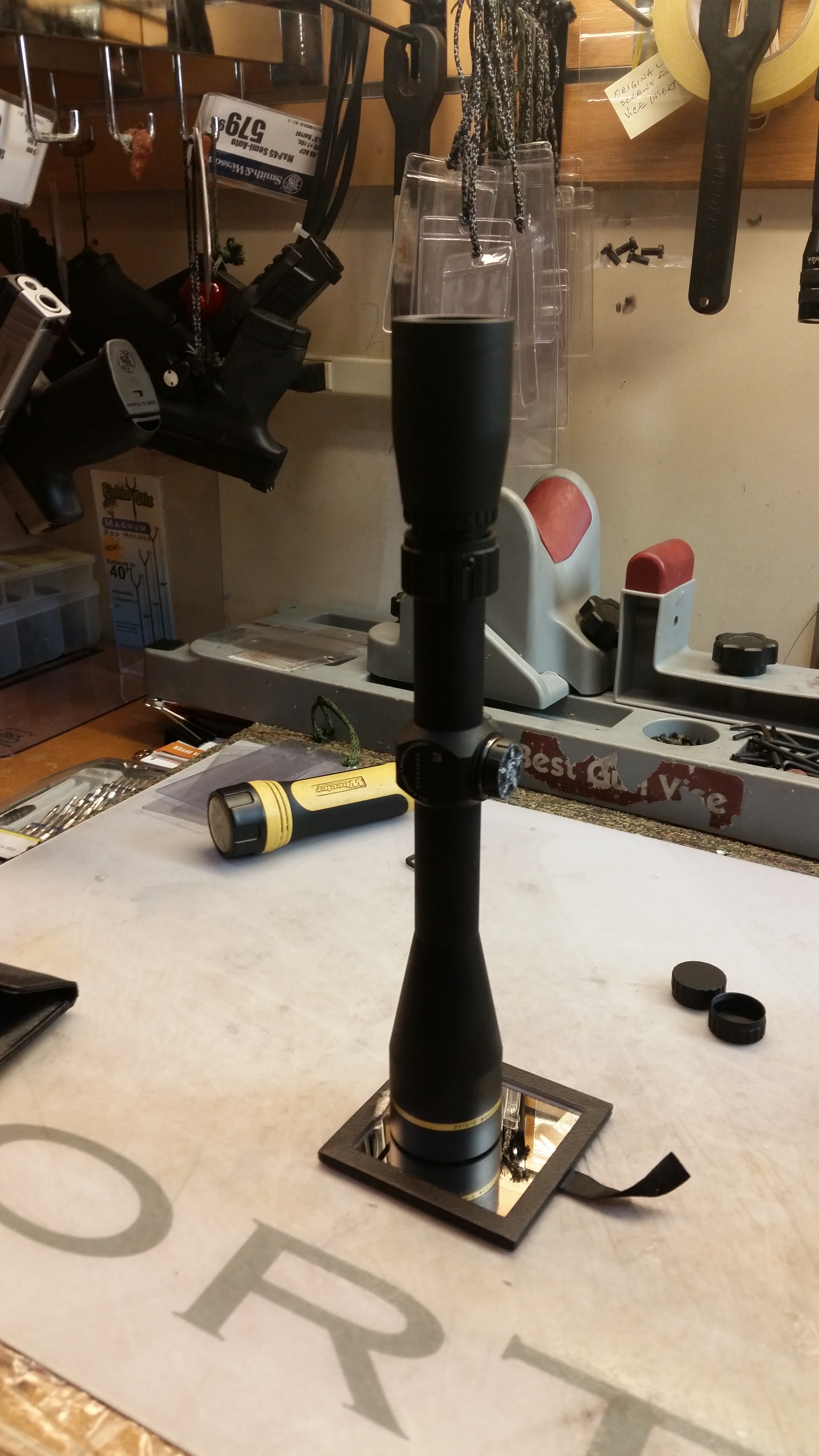

While using the bore sighter, you will need to adjust the cross hairs to match the laser (obviously). What you don’t want to do is adjust your elevation/windage so much you either tap it out of room or don’t leave enough room to make adjustments on the range. If this happens, stop. Start over. Reasoning being there may be one little thing throwing off your entire scope. (Could also be wrong size height in rings). Which brings me to my next point, the scope should not be resting on any part of the rifle. The eyepiece, the power ring, the bell, etc should be clear. Everything between scope, rings, rail, etc should have a snug fit, no gaps. I mentioned earlier about tapping out the scope, there is a trick to zero in the scope if you need to. With the scope free, rest it standing on a mirror with the eye piece up. Depending on the scope and your lighting situation you may need to acquire a flashlight or prop the scope to hover over the mirror to allow light to pass. (A mason jar lid between scope and mirror works great). Look thru the scope. The mirror will reflect the reticle back to you. You then make all the adjustments to align the crosshair and it’s reflection. This will zero in the scope to itself. Oh! And another side note…if you try everything and can’t line it up with the bore sighter there’s a chance the bore sighter itself is not resting securely or it could even be bent. (I have spent enough very frustrating ‘wtf’ moments only to find out the bore sighter was bent.) I think that’s everything… :smile:
@Kelly can you post a photo of your mirror setup? Not quite picturing it

20190410_152736
Photo of scope on top of mirror. Eye piece up

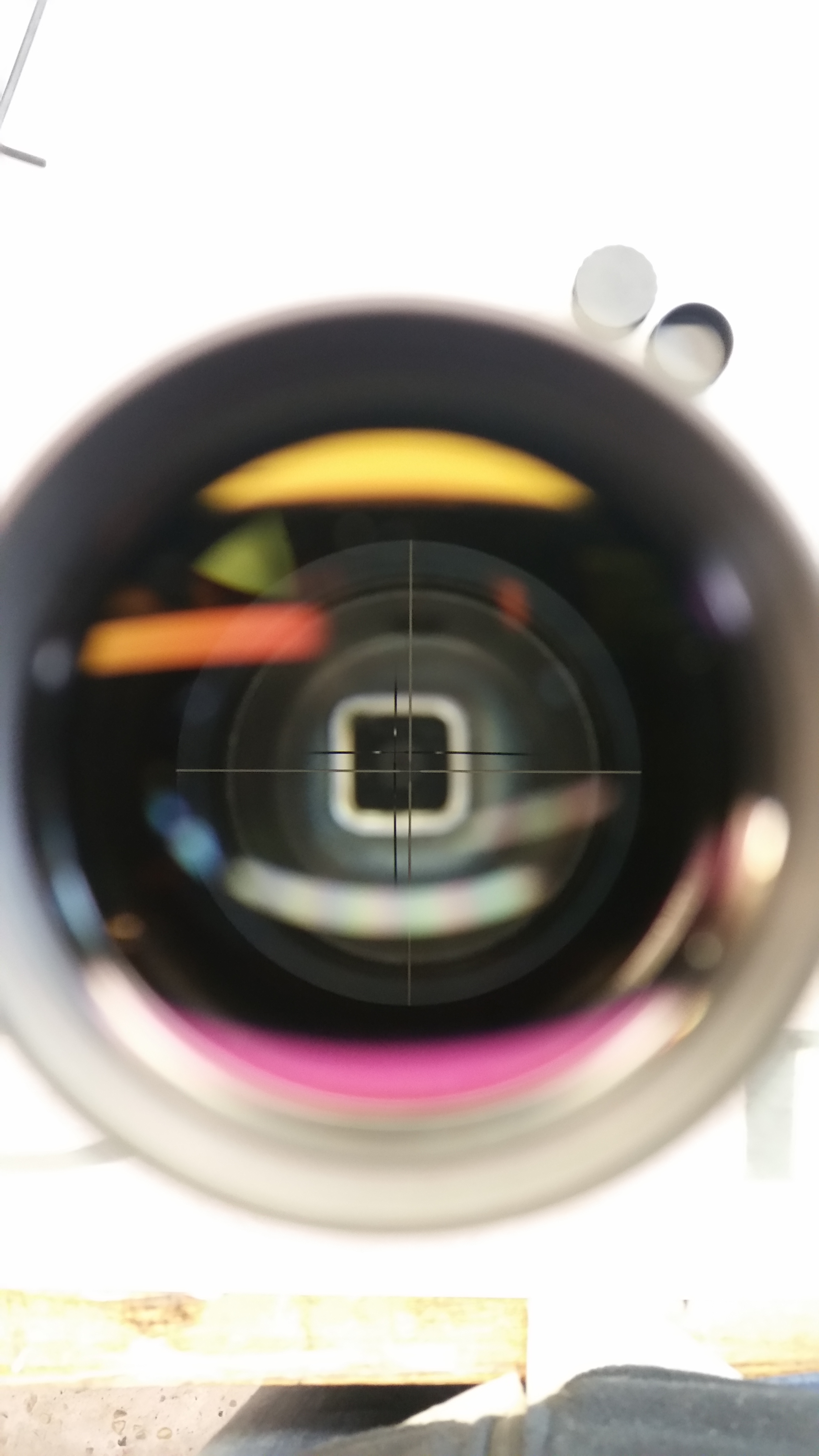

20190410_152715
It’s hard to see but it’s there. This is a photo looking into the scope. You can see the actual cross hair as well as its reflection. See how it’s high and left? With adjusting windage and elevation I brought it to zero itself. Once I mounted it with the bore sighter it only took a few tweaks to get it on. Does this help?

I find myself checking every scope I touch. It helps mounting to know the scope is on first before trying to adjust the scope around an incorrect mounting. Or when someone brings in a scope they pulled off a different firearm to mount to a new one. We had a Leupold rep come in with do scope mounts once. It was a neat trick he taught us.
