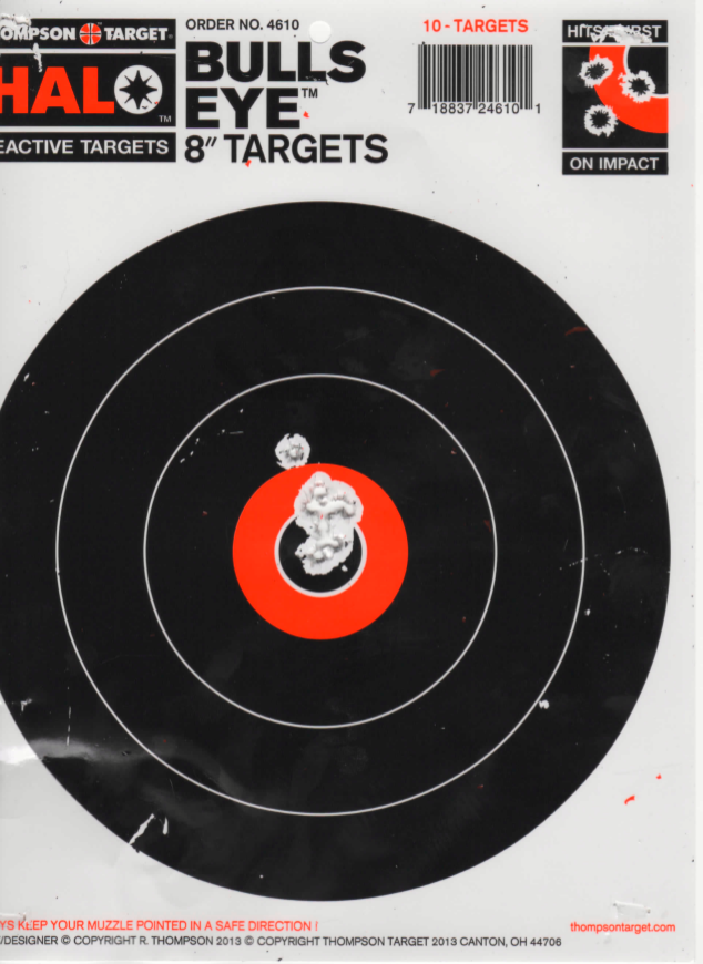

Thanks for the offer, brother. So a 20" .308 vs 6.5 Creedmore? Got to take my 16" 5.56 out a couple weeks ago and think I found the right load for it:
62 gn Hornady BTSP.
