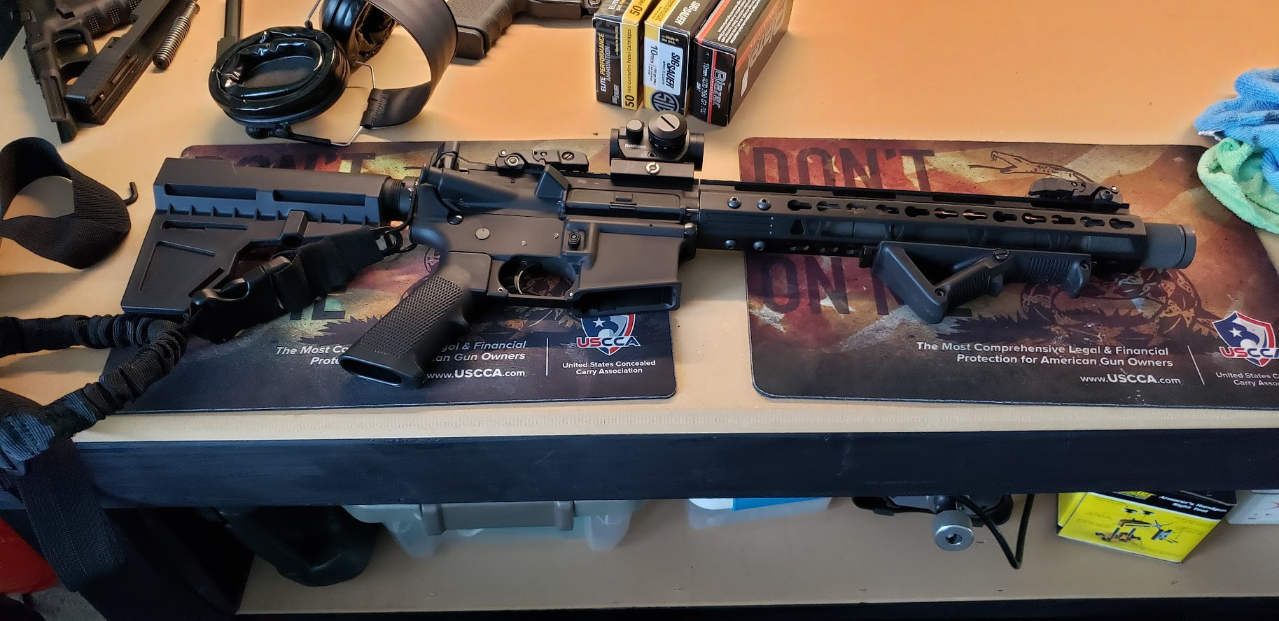

This is my sub-$500 bug out bag gun. It has over 900 rounds through it and zero issues. This is mostly a proof of concept gun. I went with budget everything, trying to see where the weaknesses are. I know the $20 optic may be the single weakest point, I will upgrade that first as my funds allow. It is accurate out to 200 yards maybe further. I only have a 200 yard range. I have trained with it and that is where the bulk of the rounds on it came from.
Nice cleaning mats you’ve got there, @_Robert!
@Dawn after I took this picture, I realized those cleaning mats were in the shot! I am thinking I hope no ones thinks I staged them in order to prove I am a fanboy!

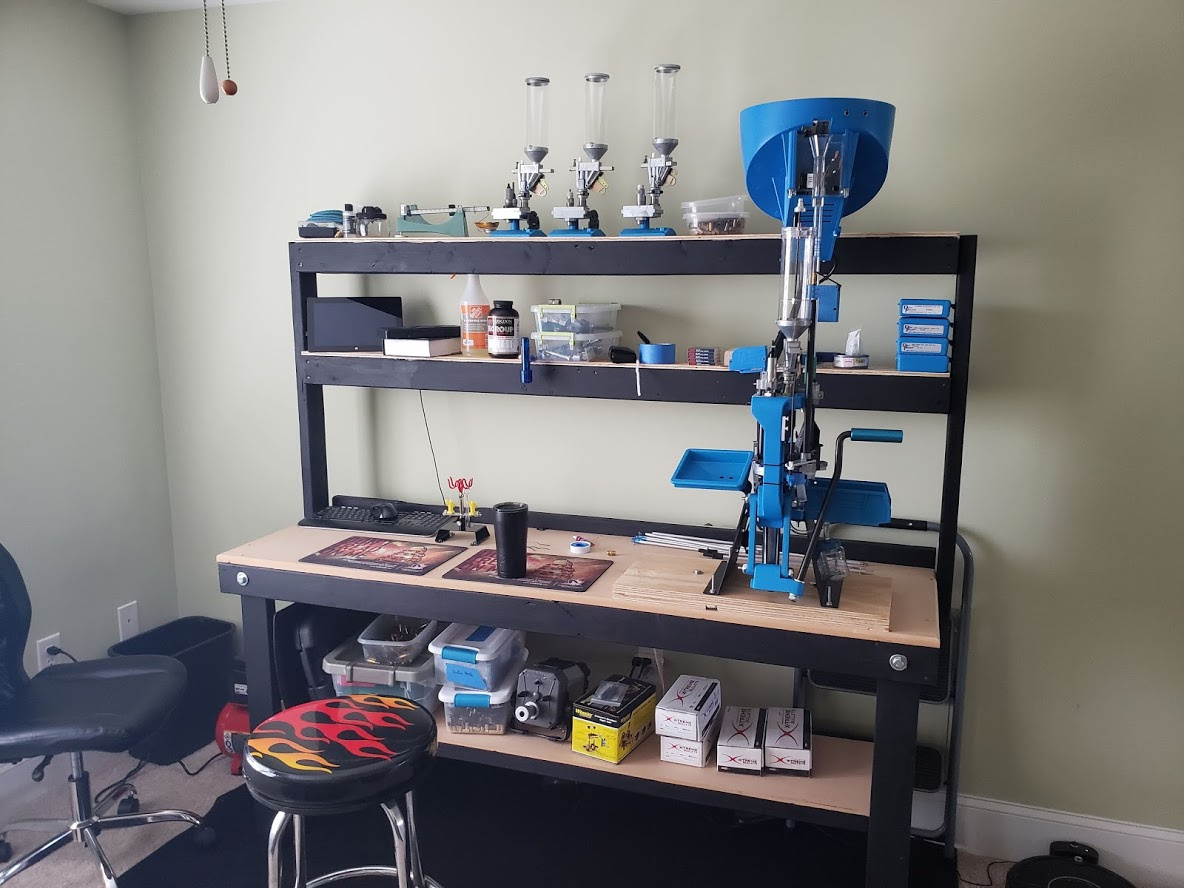

Here is a picture of that same bench with the same cleaning mats from 9/2018!

@Dawn This was the youngest daughters room. After she graduated from college and got out on her own, this is how we reclaimed it and the adjoining bathroom!
