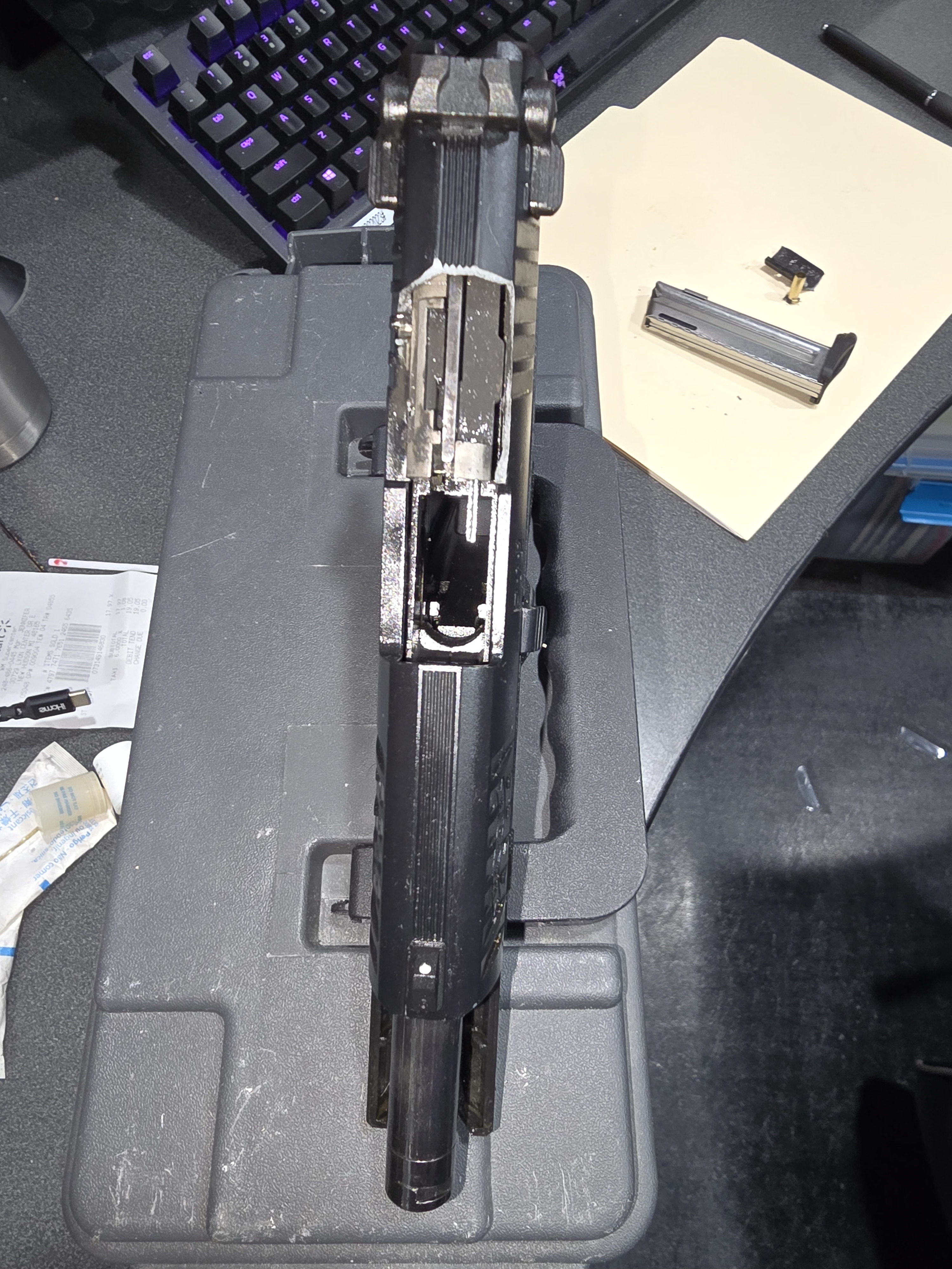

Today, my favorite plinking pistol blew up in my face when a defective .22 round exploded during training.
My Walther P22 receiver fractured hurtling metal from the weapon into my glasses. Thank God for polycarbonate!

Range safety officer checked the weapon. No evidence of obstruction. He thinks the round was overloaded.

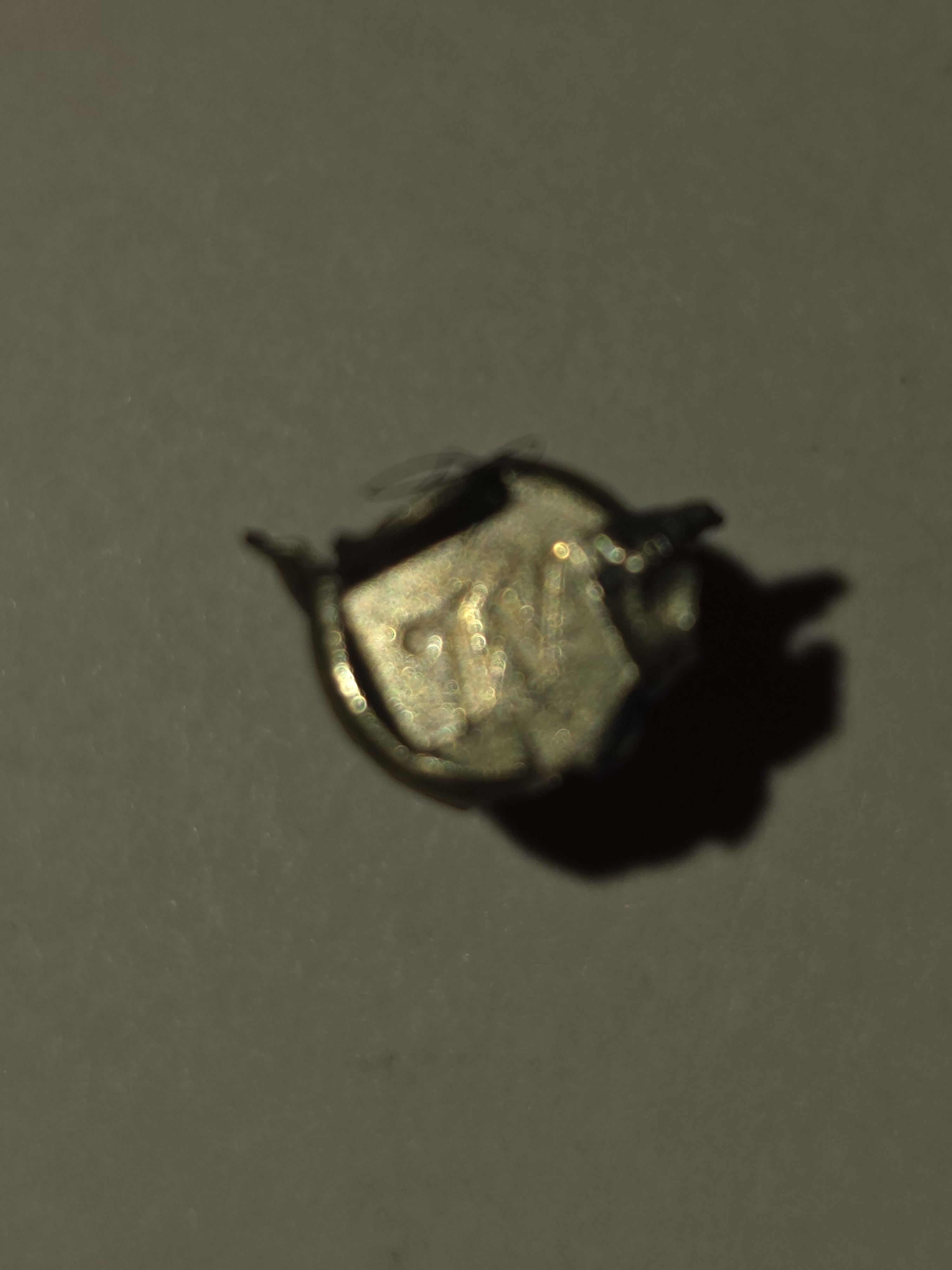

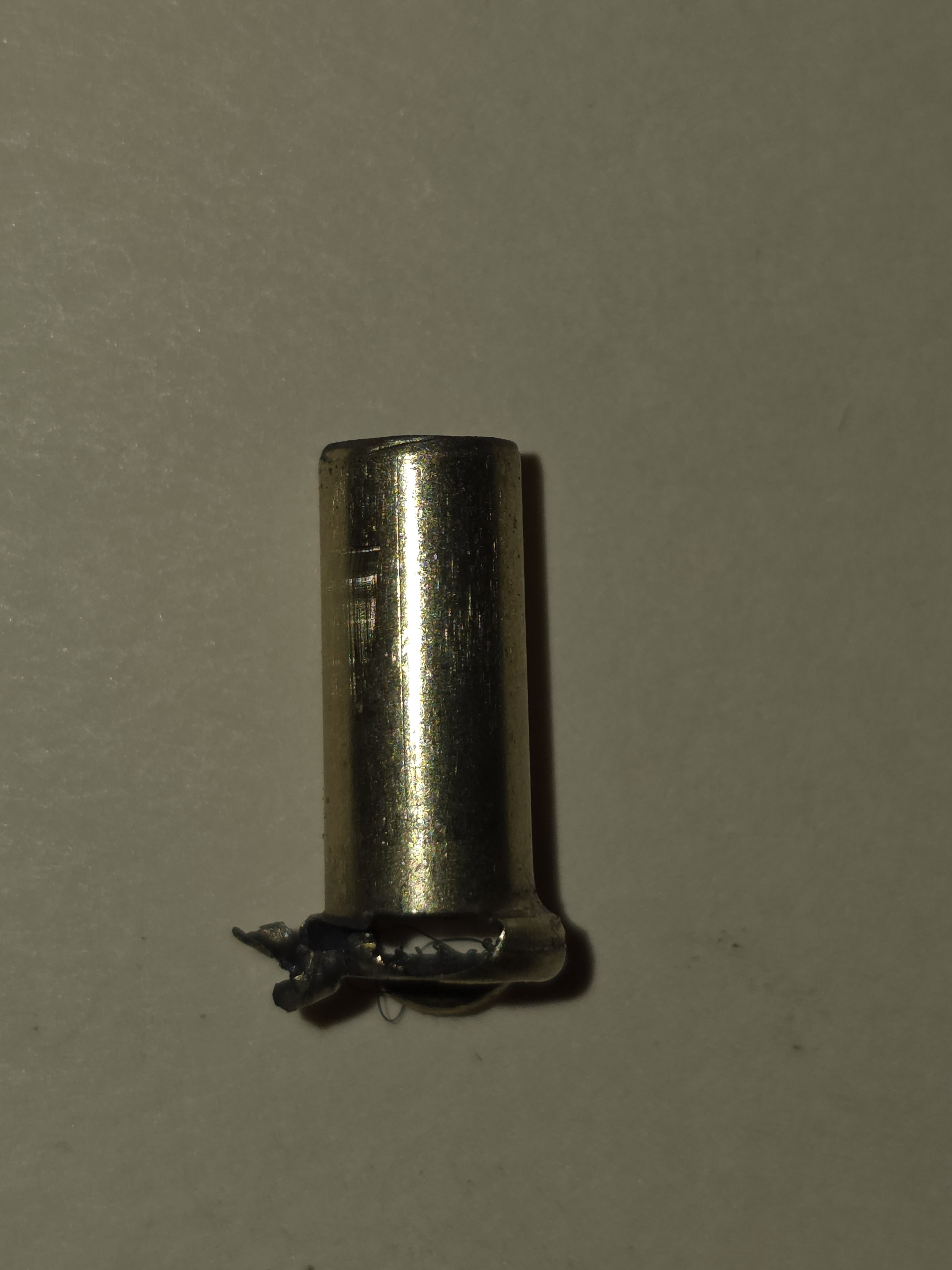

Winchester is moving very slowly in responding to my claim. They want Walther to replace the gun while they do a forensic on my ammo. I’m sending back around 500 rounds at my own expense along with pictures of the failed round and destroyed gun.

That’s what Walther advised me. They are replacing my slide at no cost. Classy company.
(attachments)
Is this P22 or P22Q model?
Are they inspecting the whole gun? Or just sending a new slide?
Walther is sending me a new slide for the P22. . Ill take the gun to my local range and let one of the gunsmiths give it a look over.

Not really. Probably overloaded round. You should see the cartridge.
Do you have pictures?
