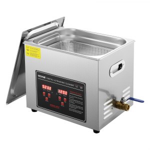

I have a ultrasonic cleaner and love it. I got mine from Vevor for less than $115.00. I use it in my gunsmithing business and to clean my own firearms. I use a ultrasonic cleaner I purchased off Amazon, just do a search for ultrasonic gun cleaner. I own two CANiK pistols, the Mete SFx and the MC9LS and both mine get cleaned and properly lubed every Sunday evening. Some people say in obsessive, but to me gun cleaning is therapeutic. I’ll attach a link the this post at the end for a 10L ultrasonic cleaner for about $120.00. Keep a lookout on this site, sometimes they run discounts.

I appreciate the link and recommendation - follow up question though: I wouldn’t want to get something bigger than I need, so for a full size pistol and an AR BCG, is 10L too big, could you go with a 3L or 6L?

The unit I use is a basic one from VEVOR, large enough to easily hold the gun parts.
(Side note - The drain on my unit failed after the first use. I dismantled the drain, and found there was some kind of strange o-ring or gasket right at the valve that was basically blocking off the flow. Removed it, and it has worked great since.)

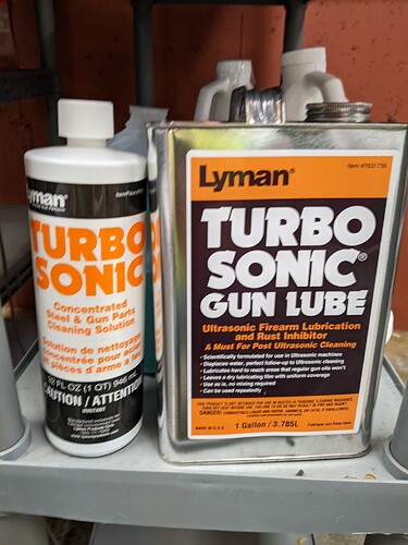

I use two different solutions, both from Lyman Turbo Sonic. One is a cleaner in a concentrated form (dilute with water). The other is a lube you use as-is. Both can be saved and re-used.
NOTE - I said above I clean MOST of my handguns. This stuff works great on any gun, but NOT on some accessories. So unless you can easily remove them without messing up any calibrations, do not run things like red dots through the ultrasonic.
I had a 6L that a customer shot (don’t ask, accidental discharge in my shop), so I made him buy me a new one. At the time the 10L was cheaper that my 6L was. With a 6L I could only get 1 gun in at a time, the 10L 2 will fit nicely.
