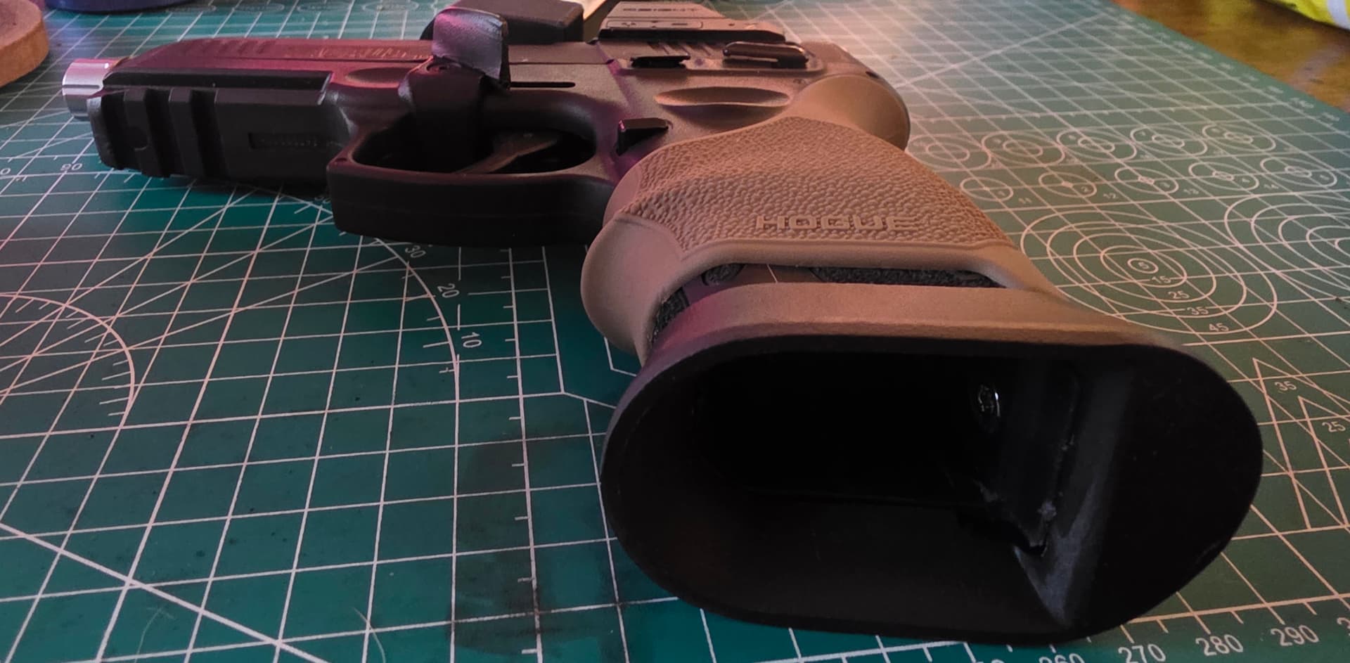

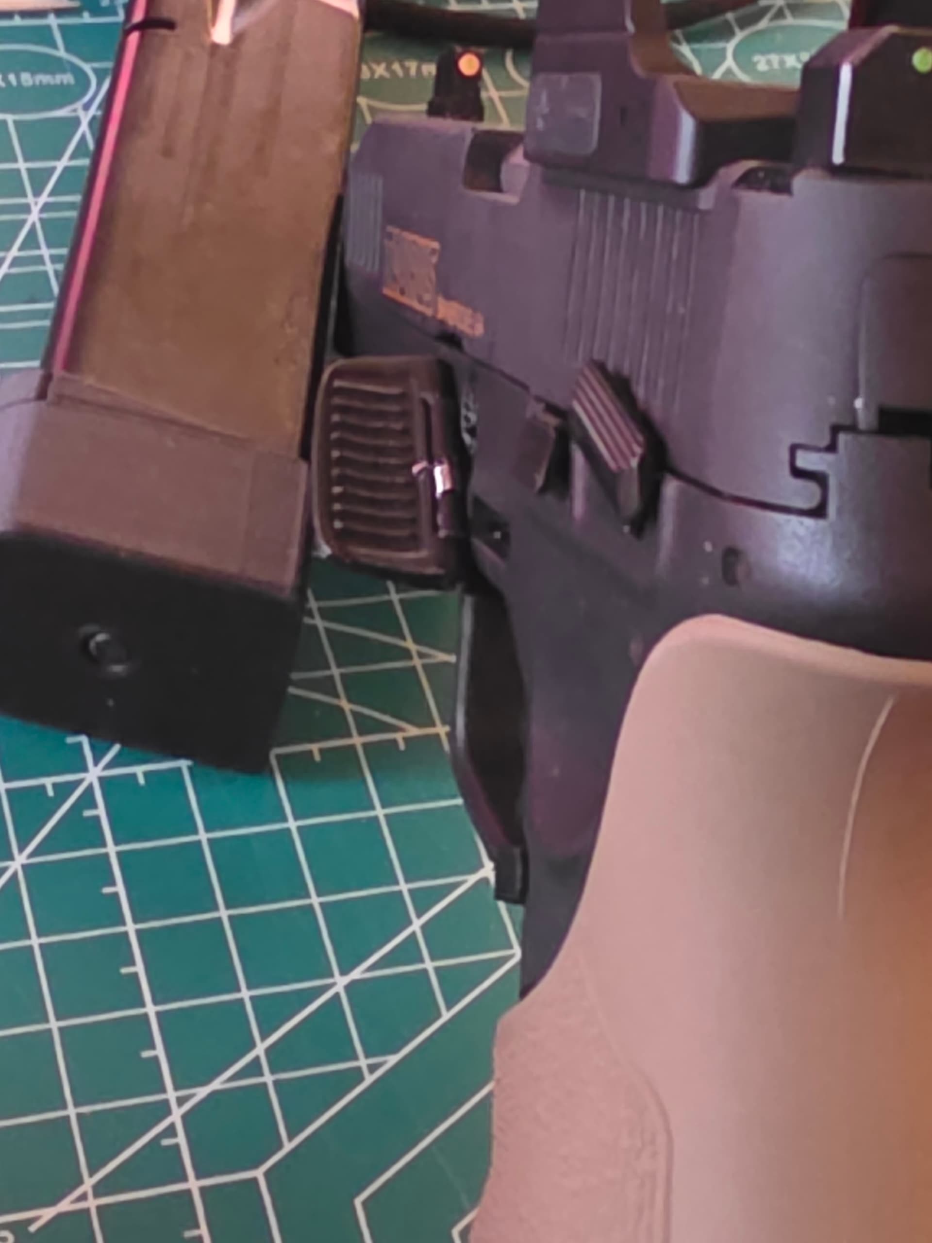

Still messing around with turning a cheap pistol into something competition worthy.
These should be my last upgrades, but I finally got my magwell and gas pedal installed.
Famous last words if you ask me, I have a Mossberg 88 I keep dumping money into but damn is she a lot of fun.
There’s really not much I more I even can do to this pistol except replace the trigger, but I don’t want to do that because most of the aftermarket triggers disable the restrike feature that I use daily for dry fire.
I’m still gonna upgrade my stuff, but I can’t really even think of much else to do to this one.

What is it?

I’m not a competitive shooter, so please pardon my ignorance…
What is the function of the gas pedal?
Recoil control by additional leverage with the support hand thumb.
Taurus G3, heavily modified.

Thanks, I meant what was the last modification? Was it the grip or the thumb thing or something else?
Two things were upgraded at the same time. The magwell funnel was one, and the “gas pedal” (the thumb rest by the takedown lever) was the second.
Oh. I didn’t know that was called a gas pedal. I couldn’t see the funnel. Learn something new every day.
