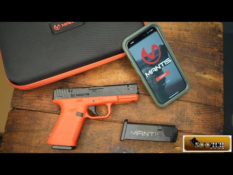

I know… Mantis made something less expensive and more complex than SIRT.
I cannot say anything about it because I don’t like Mantis… It never worked for me. :zipper_mouth_face:

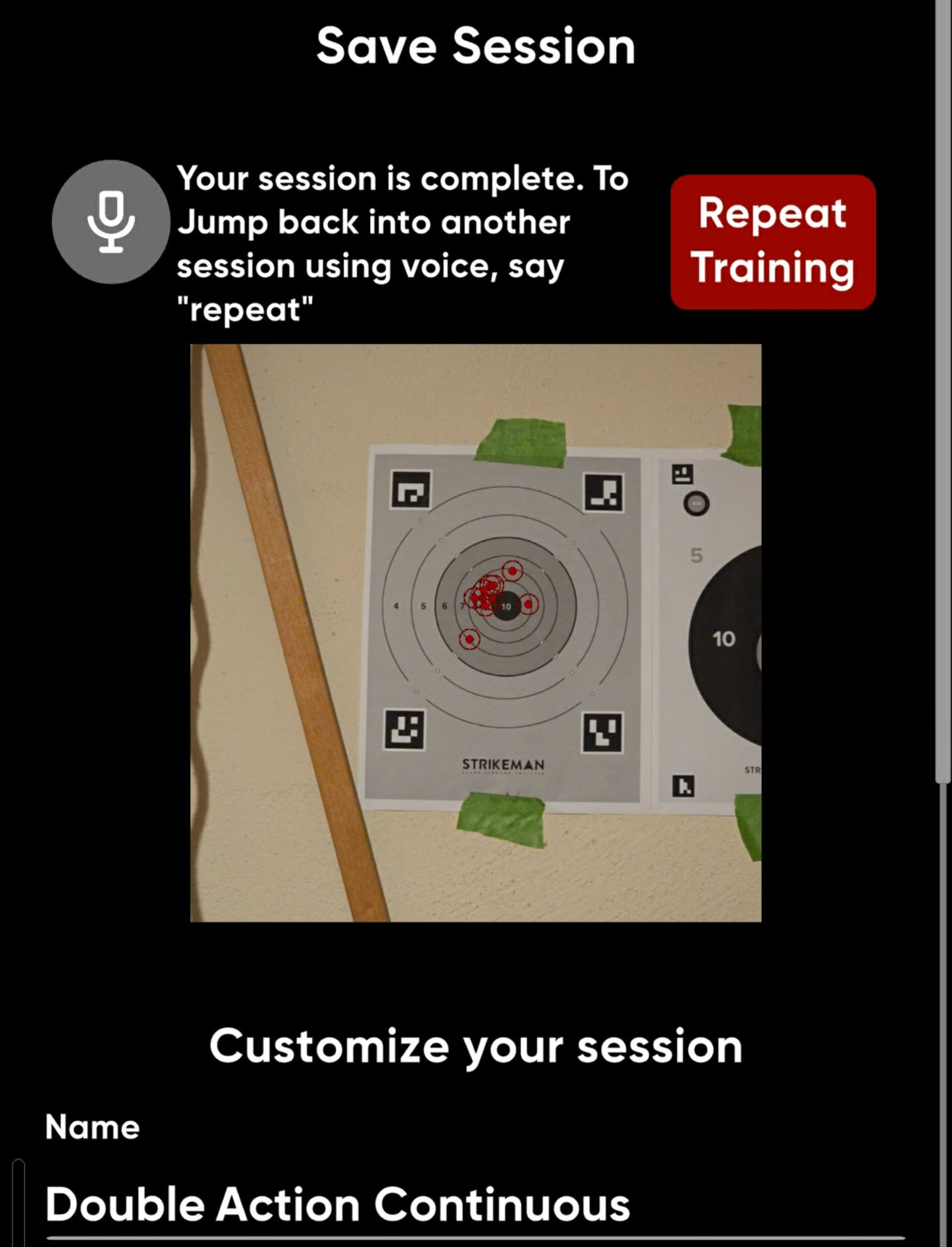

The app seems to be what makes or breaks the set up, since the app is free I downloaded it, printed off one of their targets and tested with a laser pointer to see if it would register hits etc. Once confirmed it did, I got a cheap generic laser cartridge , since I already had a phone tripod adapter, and tried that with the printout.
Like someone said earlier, if you don’t have a DA/SA it can be annoying, I was seeing what it would show when I tried to continuously fire double action only (full pull of the trigger without cocking the hammer first) at 20 feet (paper being 8.5x11 letter size) to see how tight I could keep the grouping with an 11-lb trigger pull.
As opposed to working on iron sight precision with pulling back the hammer each time.
Edit: The other app, called LaserHIT which seems to be advertised with a lot of the facebook ads in competition to Strikeman or Mantis, was of rather poor quality I uninstalled it right away. Also noticing the physical electronic targets they had were the same kind of units you’d get off amazon for $14.
