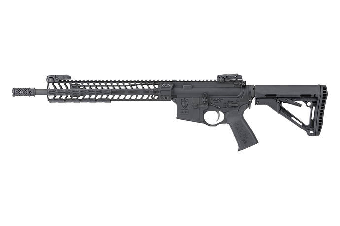

This is what I got. I must say, that I love the thing to pieces.
The “cosmetics” were what originally caught my attention, but as I looked into it, it started to sound like a good rifle. When it showed up, the guy who owns the gun shop I frequent looked at it and said that it had come pre-set up the way he had his, and that I had saved myself several decades of frustrating experience getting it set up that way. It’s a bit expensive, but I, who admit I really know nothing about any of this, am well pleased with my home defense Go To.

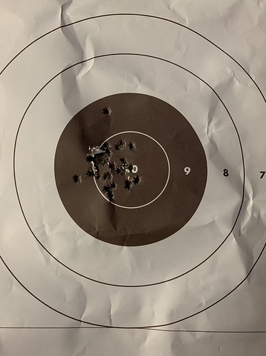

My first time out with my new Colt M4A1 SOCOM.
