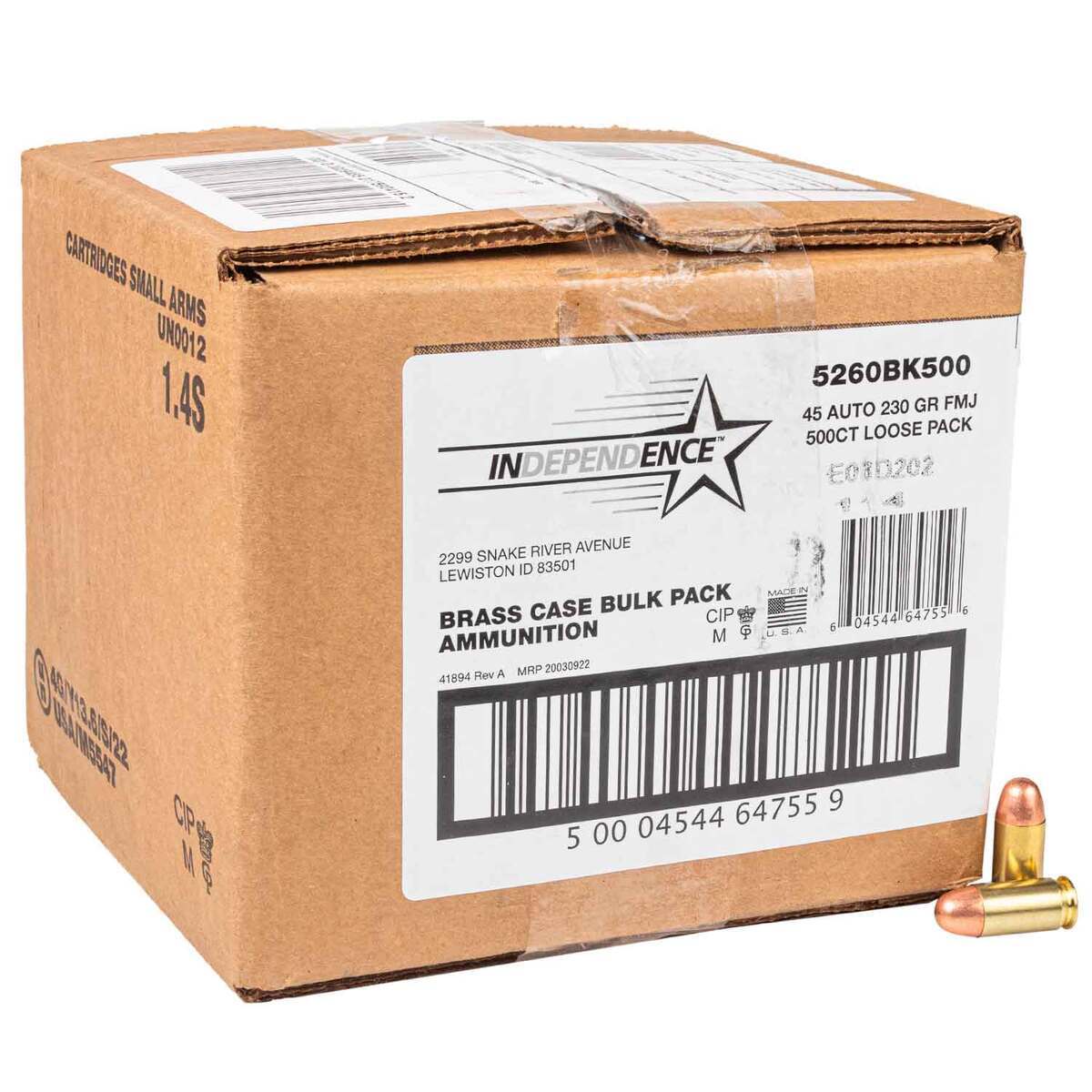

What are your thoughts on Federal Independence .45ACP 230 gr FMJ 500 packs?
Is it good range ammo or not?
LP or SP?
Brass or aluminum cases?
Reliable for range work or iffy?
Does it coat your hands with soot at the range?
Does it compare with, say, PMC or Magtech, UMC or WWB?
Do you mean CCI Independence?
I don’t trust anything federal
Thats the box! Sportsman’s warehouse must have mislabeled it on their site.
Independent Ammo is a brand, made under Vista Outdoors umbrella, who owns Federal and CCI.
That’s why you see both names, however it’s the same ammo.
I’ve shot 9mm version of it and never got issues.
Don’t expect ā€œwhite gloveā€, unless you clean each bullet with acetone. :wink:
It’s a brass case and works great as cheap range ammo. Nothing bad and nothing special about it.

If it meets the 4 qualifications above I’m good to go. I have probably shot a bunch of Independent Ammo but hard to remember since I buy bulk ammo and immediately dump it into Military Metal Ammo cans with only caliber labels.
Why not? It seems like very consistent ammo to me. I use their range ammo all the time, and the Hydrashok Deep for SD ammo in a .380. Never a single failure to fire or failure to feed in any of the guns I shoot with Federal.
